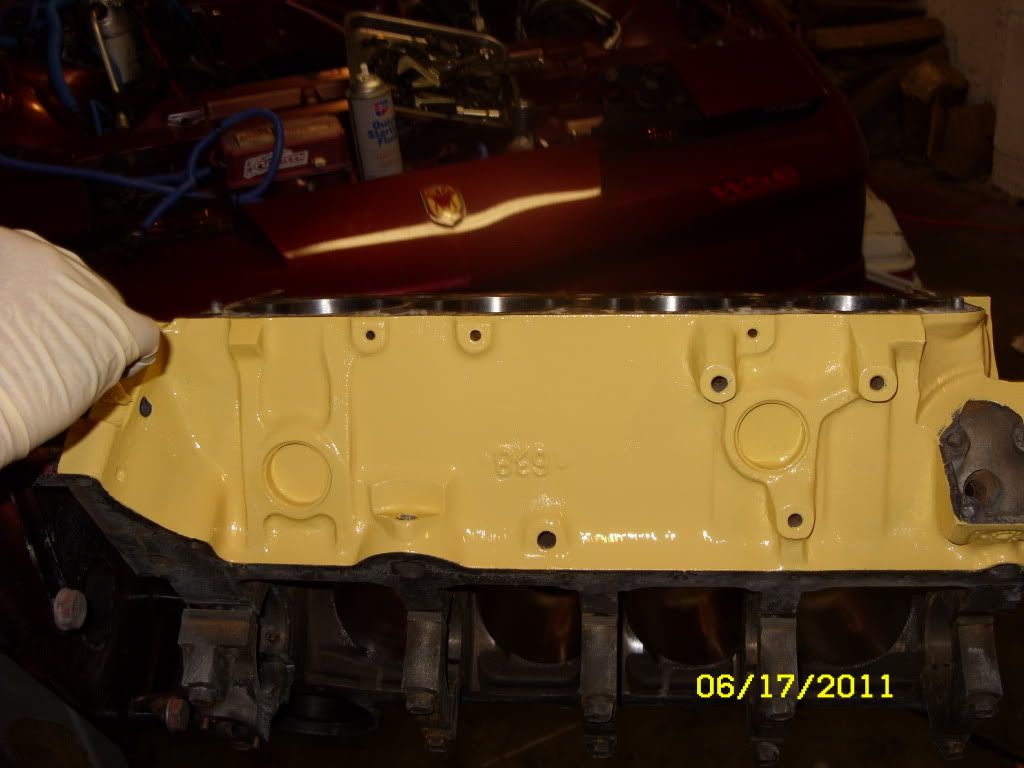

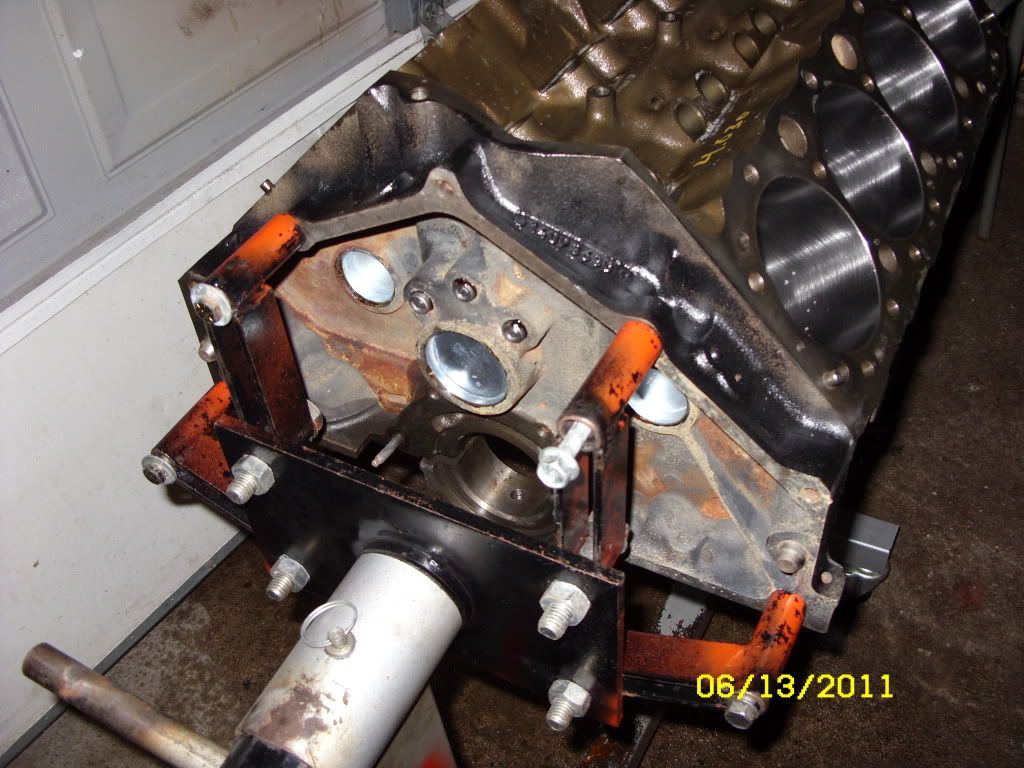

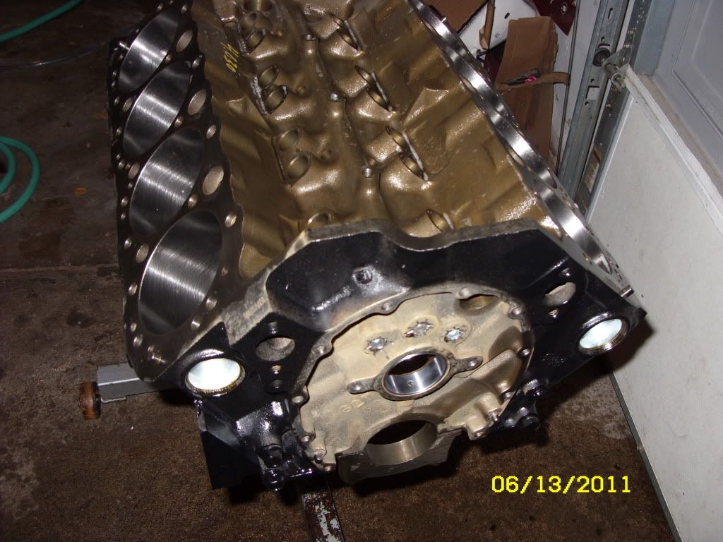

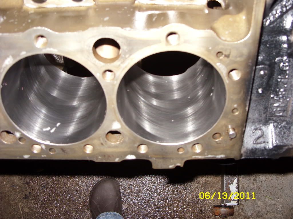

Just got the block back from the machine shop but wasnt too happy with the hone job.What do you guys think?Its good to see some posts to Toxic's build recently.Trust me mine is on a way underfunded scale compared to that.Its going to be some flat top -6.88 ,1.560 pistons of some sort havent picked the pistons at this point but cannot afford forged.Alot of the local circle track guys around here claim to stay away from all hyper pistons and just go with a cast.Im open to sugestions.Not wanting a stock skirt profile due to having previous cracking issues.Just going to overhual the stock 083 heads nothing special.Cant really afford anything fancy.I just figured i would post some eye candy for the true gear heads in here like myself.more to come im waiting on the paint in the mail atm going with por-15.

What is it exactly, about the honing, that you don't like?

Well the block was square no no decking,Line bore wasnt needed ether.Basically because i was lazy i had them throw the freezeplugs and cam berings,acid tank,bore+hone (.030) They do all the oil gally plugs as well.
I trust the info the shop guy gave me if i ever had to run life or death from somone or catch somone that just took my child or somthing I would want the engine to withstand the hell i would give it.
I guess its better to have it and not need it rather than need it and not have it.
I bet in all reality i put 1.5-3k miles on this car a year.Its your typical garage queen.Just tring to get the car to a point where i can sit back and look at it and say to myself yep its done. Im the third owner and man this car had a horrible first owner.Definately not a one owner car you would want.She has 64k and needs motor trans and rearend rebuilt..
It was an ohio car from 87-09 so the whole k member has a lovely orange coat of surface rust over it.Thinking of rolling that from under the car while the motors out.Soda blast and coat it.Or possibly get a tubeular one.Just worried about what mods i can do without takeing away from the value of the car.
The thing i didnt like about the hone is the hatches wasnt uniform throughout the cylinder.Looks as though theres a change in it at about where the piston reaches the botom of the intake stroke.

Have you ever watched how the honing machine works? The spinning of the stones is a constant speed, but the stroking action is fast in the middle of it's travel, but slows , stops, and accelerates again, at each end.
Now you won't see this at the tops of the bores, becaust the stones can be pulled about 45% of their length, out of the bore, each stroke. But at the bottom, you can't run then much more than 1/4"-1/2" out, because of the main webbing.
As the stroke slows, the cross-hatch angle becomes less. So at the bottom, it's less than ideal, but 2/3-3/4 of the way up, the angle is more than ideal.
What you're seeing is perfectly normal, it can't be done any other way.

from what I can see I have no concerns about the honing. It looks fine but again, based upon the photos.

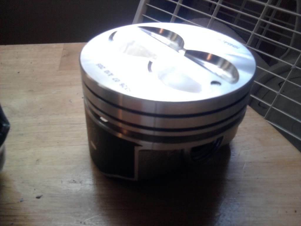

Hey again! Im a little bummed out right now,Just recived the piston and ring set and recived an open box from jegs.The pistons looked good but three of the lower rings had small nicks in them.I am sending them back it will be a week before i get newones
Sad to see jegs sending open stuff to custumers.Its ether that or maybe somone is looking for a bonus at fedex.Ill post again when rotateing assy is complete.

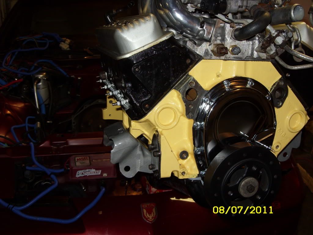

Still waiting to get the heads back but all the rest of the block is together.(pics soon).
I have a question.. As im looking to reinstall the oil filter adapter with the bypass in it im wondering if i should spend a few bucks on a adapter without the bypass.I purchased the m55hv oilpump i know ill prolly never need the extra volume but figured whynot.Its a normal pressure high volume.Should i remove the bypass adapter and replace it with a non bypass one?I plan on useing decent filters in the future and from what i understand is most filters are made with the bypass inside the filter anyhow.Anythoughts on this? Thx.
