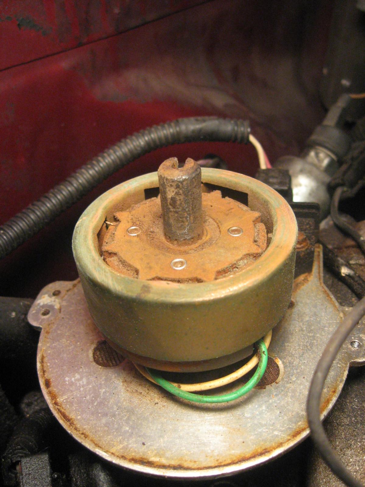

Off came the cap, then the rotor. Ah the rotor. I couldn't pull it off. I tapped on it with a small hammer & dowel. In the end, I had to use a piece of wood as a level surface to use a hammer to pry off the rotor. It seems that the stem was incredibly rusty ("Rusty and stuck.jpg") and the ground plane (the large metal surface onto which the ignition module is mounted) had a somewhat greasy residue. Maybe it was just a mixture of carbon, moisture, and the silicone from under the ignition module?
Unfortunately, I wiped the residue off and somewhat cleaned-up the shaft with #320 sandpaper on which the rotor mounts prior to taking the attached pictures.

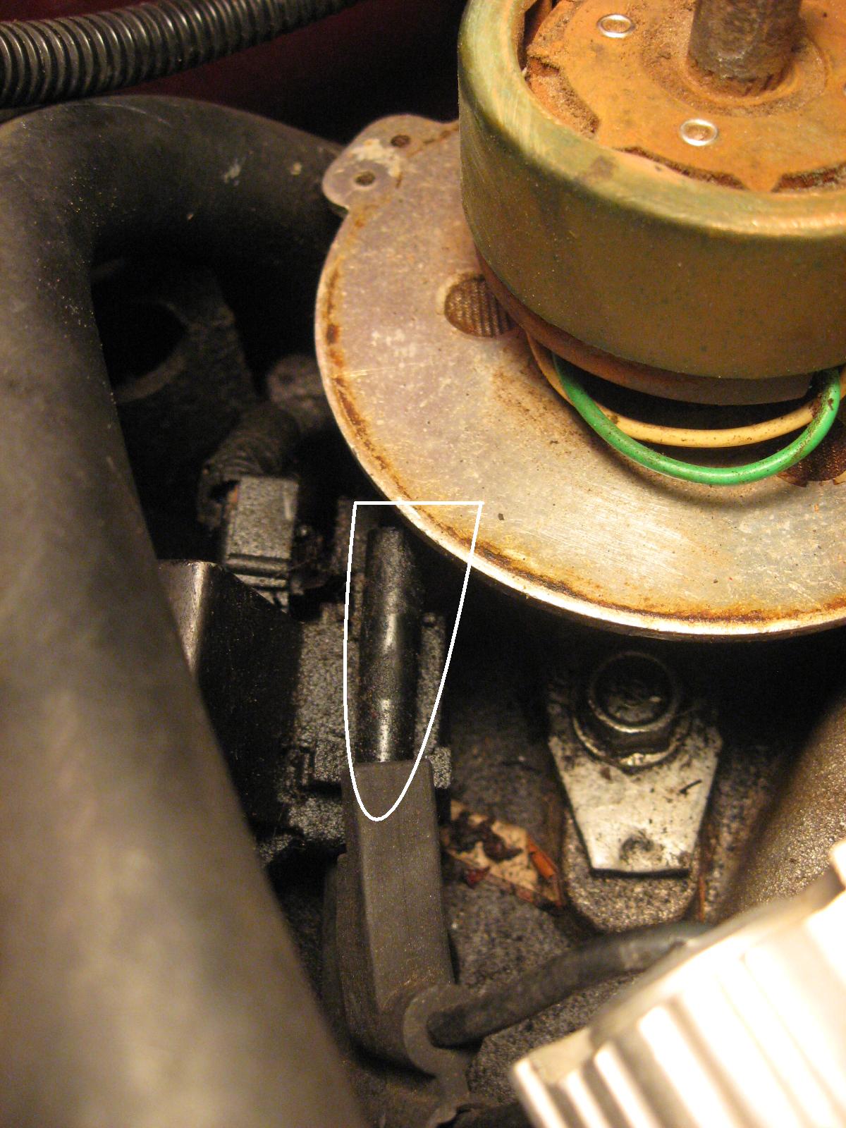

I then noticed that there is a connector to which a vacuum line should be connected. The open tube seems to come from from the EGR, but I don't see any rubber lines in the vicinity which would connect to it ("Missing line highlight.jpg"). Maybe this is why it was running rich????
Could the residue from under the cap be due to bad seal on the distributor shaft? Need I pull the distributor shaft and put new seals? And what is the vacuum line that I'm missing?

The plastic line goes to a rubber boot thing the line you have highlighted is pointed at the boot looks like it slips into that from what I can tell. Hope I have helped somewhat. It wouldnt hurt to change the distributor as maintenance since its destined to fail. But I wouldnt worry about the whole distributor as much as the ICM.

As for the ostensibly missing hose, I looked at another co-worker's '87 IROC and he has the same "connector" without a hose connected to it. This sits at the end of the fuel rail on the passenger side, near the ignition coil.

thanks, kingrounds; however, it's not the to the egr. this looks like a 3/16" to 1/4"id hose fits on the ribbed stem. it's highlighted in the second picture of my original post. my post at 11:46am was misleading: it's at the end of the fuel rail, but not on it. the object to the right in the picture is an electrical connector.
i looked at the egr and it's hoses are connected.
again, my co-worker's '87 iroc has the same "missing" connection.
