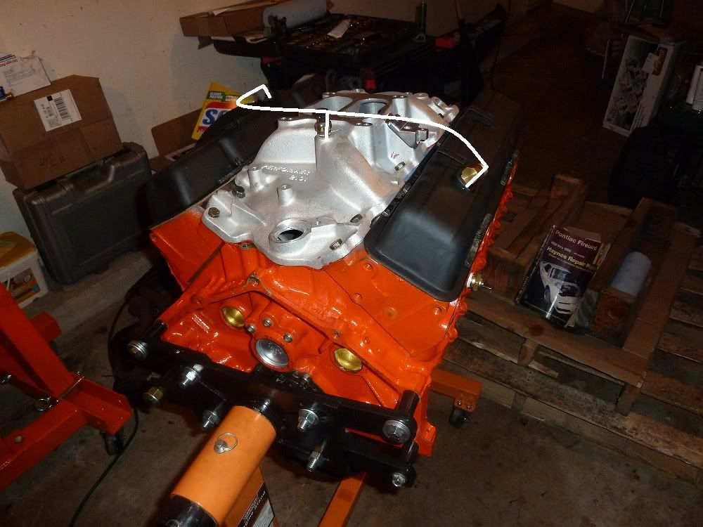

Someone on another forum, a local club that i'm friends with, informed me that the driver's side should NOT be attached to that T, and advised on how to fix it for troubleshooting purposes. So here's what I did.
I removed the T, put the (passenger's side, above #8) pcv hose directly into the intake manifold. I zip tied a piece of used laundry fabric freshener onto the end of the hose from the driver's side (above #1). The device that was in there, above #1, is a closed cylilder that has a one-way valve in it, allowing air to travel OUT OF the valve cover (much like the pcv valve, only bigger). So I removed that and wedged a 15mm socket into the rubber grommet, and twisted the other end of the hose into that, so the make-shift filter is on the outside. I snaked that through a hole in the a/c bracket to keep it out of the way and away from the hedder.
After I turned the car on I squirted the #8 hedder with water, and it only took 4 seconds for to burn off. Still not instantaneous, but a HUGE improvement.

NOTE: the pcv is right above the #8 hedder, and connects to a T with a breather from above the #1. Then they go into the intake manifold into what looks to me like the #8 exhaust.
From your description and picture, it looks like you had, in effect, a fresh air breather plumbed thru the T directly to the no.8 intake runner. Though there shoudn't be a hole or fitting there on a carb intake??
The effect of this I should imagine would be to lean no.8 out to the point of not firing, and also upset the mix of other cylinders. Might contribute to a number of your symptoms.
You have now re-plumbed it - basic pcv system should be fresh air into one valve cover, pcv valve out the other, and pipe from pcv valve to the intake manifold directly below the carb.
Or more usually into a fitting in bottom of the carb itself, so the metered pcv signal is mixed with the main carb signal in the small plenum area below the throttle plates.

I now have the pcv on the passenger side going into the front of the carburetor, and the fresh air on the driver's side, and I put a cap on the stem coming out of the intake manifold where the pcv line used to go in. So far it's running a lot better now.
Thank you all for your advice and wisdom.
