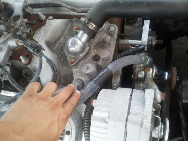

Here is a Photo of the Pump. And what it connects to.

5/16" UNF. Usually they're studs, but if they were bolts they'd be around 3/4" long. You might need a different length.
