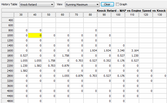

I included screen shots of the problem under the same tune except the worst example was at engine coolant temps 25 degrees (180) cooler than the less intense example ~208. There is also a zip file of the log that the worst example occured in.

I started with 59 but went back to 8F for simplicity, I just want the motor to run correctly consistently and I found it is extremely important to dial in all the important tables managing the injector PW, not just "set the BPC and go".
Right now I have a problem with intermittent wideopen performance, sometimes it flies, sometimes it goes flat for some reason low in the rpm range which I suspect maybe spark insuficiency since the motor doesn't pop like it use to but does send out a lot of **** although it doesn't show pig rich in the log at that point. I'm working on it though.
Scroll through the wideband patches and check the one for LC1, I use Zeitronix.
