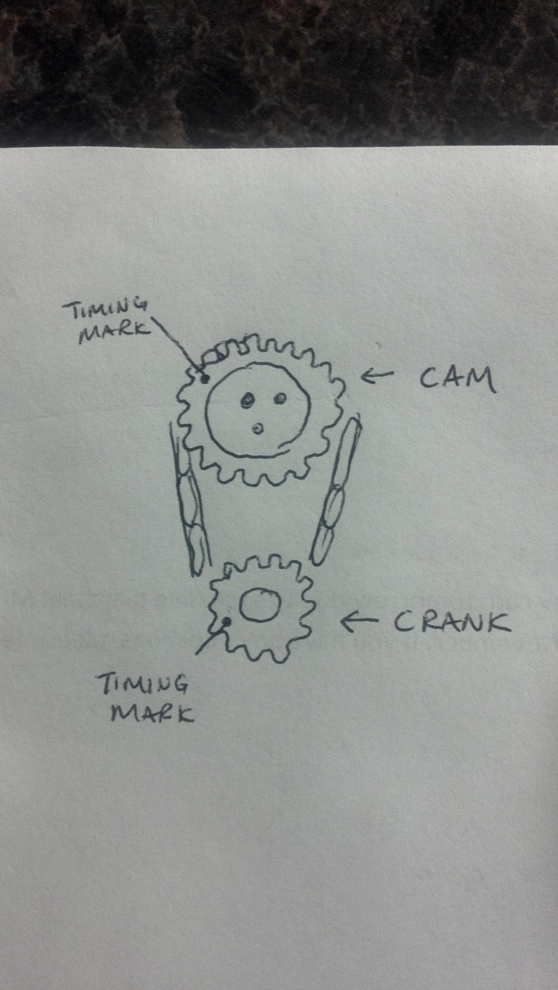

When I look at them they are even across the top after the intake stroke and remain the same on the compression stroke...I pull the dizzy cap and the rotor is nearing the #1 spark plug. I turn a little further by hand til it lines up on the zero on timing marker...I verifiied that this is top dead using the clothes hanger trick, I replace spark plug and turn it over and the first sign I hear of ignition is a backfire but no start...now I did pull the timing cover to see if my chain was stretched I took pictures and got a reply that the tiny slack I had in my chain was ok..so should I try to compensate for that slack in the chain while setting intial timing?

a little slack isnt gonna cause it to be that far off. with the timing cover off and the mark at zero, were are the alignment dots on the cam gear and crank gear?

Re: Distributor removal
Well its back on now but they were...hold on ill draw a quick picture of them...
Old Dec 4, 2011 | 05:58 PM
Not the best drawing but its readable I hope

was that how they were pointing with the distrubutor pointing at #1?

You know I didn't even bother to check when I had it off...but if I'm not mistaking aren't they supposed to be pointing in the same direction...I.e. if the crank is at 12 then the cam should be at 12 correct...if I'm wrong then I know there in the right position, they just weren't at tdc #1 when I looked at them

yea, the cam anc crank both pointing at 12 oclock is TDC on #1 compression stroke, with the crank gear at 12 and the cam gear at 6, its TDC on the exhaust stroke
Fouling prevents a proper spark, or no spark, if a plug is severely fouled it won't spark at all. Disabling the fuel doesn't eliminate the fuel pooled at the floor of the intake manifold. Depending on the ambient temperature the fuel that has pooled in the manifold will take time to evaporate, if you try to crank it, it will pull in vapors which will ignite, but not enough to start.
As to your timing statement and drawing, you show the dots approaching 12 o'clock when the rotor is almost under the #1. That's ok because the spark actually happens when the rotor breaks contact when it passes the #1 terminal, by then both dots should be at 12 o'clock.
If the mechanical timing is correct and sufficient compression is developed, applying proper spark at TDC, or even several degrees before should get it to start.
My last paragraph is in general what Travis is stating in detail.
So his question about timing (firing order) is very relevant at this time (pun intended.)
