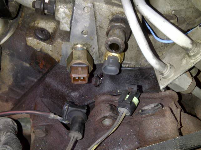

What is are the 2 electrical plug "thing" (sensor?) on the front of the block above the timing cover, just below the IACV?
One directly below the IACV & the other right beside it, in the middle of the engine? The middle one seems to be broken & have no plastic section for the plug to hook to, just 2 electrical stubs sticking out to plug on to. Plug has 2 wires,1 black, 1 yellow. Coolant Temperature Sensor?
No idea of the other sensor beside it wire colors, as I have not pulled away the loom to see, but anybody know what that sensor is too?

Here is a pic of the broken sensor. Not sure what it is or what the other 2 sensors are. Anybody know?
Since I'm having running issues & find a broken sensor? You never know what could be contributing, since not every single sensor sets an error code when broken. What sensor is that, so that I can replace it? What is the sensor to it's left too?

no tpi expert but that looks like an important temp sensor in your pic. code 36 is a bad burn off relay if i remember? should be on the firewall? if its not working correctly your maf sensor can get built up with crud. theres probably a thread on here about setting your tps. a service maual can walk you through it too. youll need 3 short pieces of wire & a multimeter. id also check for vacuum leaks & bad grounds. clean every connection you can. i went through something similar once only to find the timing was way off. i guess the computer was compensating for the wrong timing? hope you guys find your gremlins.

But It seems the CSI runs when the Cold start switch tells it to. So your switch may be bad as well (Or instead of)

Looking Online, nobody local has one, so it has to be ordered. I know mine is broken so it needs to be replaced, just wasn't sure that it was a cold start-only sensor or just a temp a sensor for the ECM. Since it is broken, it could very well be the cause & needs replacing anyways.

Where did you find it? My broken one is the one on the right in those pics. http://www.autozone.com/autozone/par...questid=455577

THe one on the right is just a temp sensor. $8-$20 at Rock auto..... THe one on the left is the Cold start swich.

Replacing any part of the cold start system is a bad move. The need for that system can be removed with a proper chip. I had an '87 and burned an '89 chip to remove the system. Worked great for many years. That whole thing was just a band-aid from GM.
