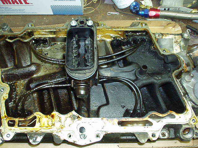

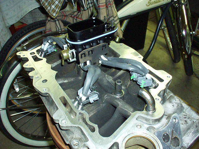

The upgrade part goes in the same place, cost about the same as an oem replacement, & is much more reliable. The one on the left is oem, the right one is trhe upgrade.

I don't know if the fuel pressure regulator is available seperate, you might what to check if it is. You can see it in the first picture at the bottom of the main body.
