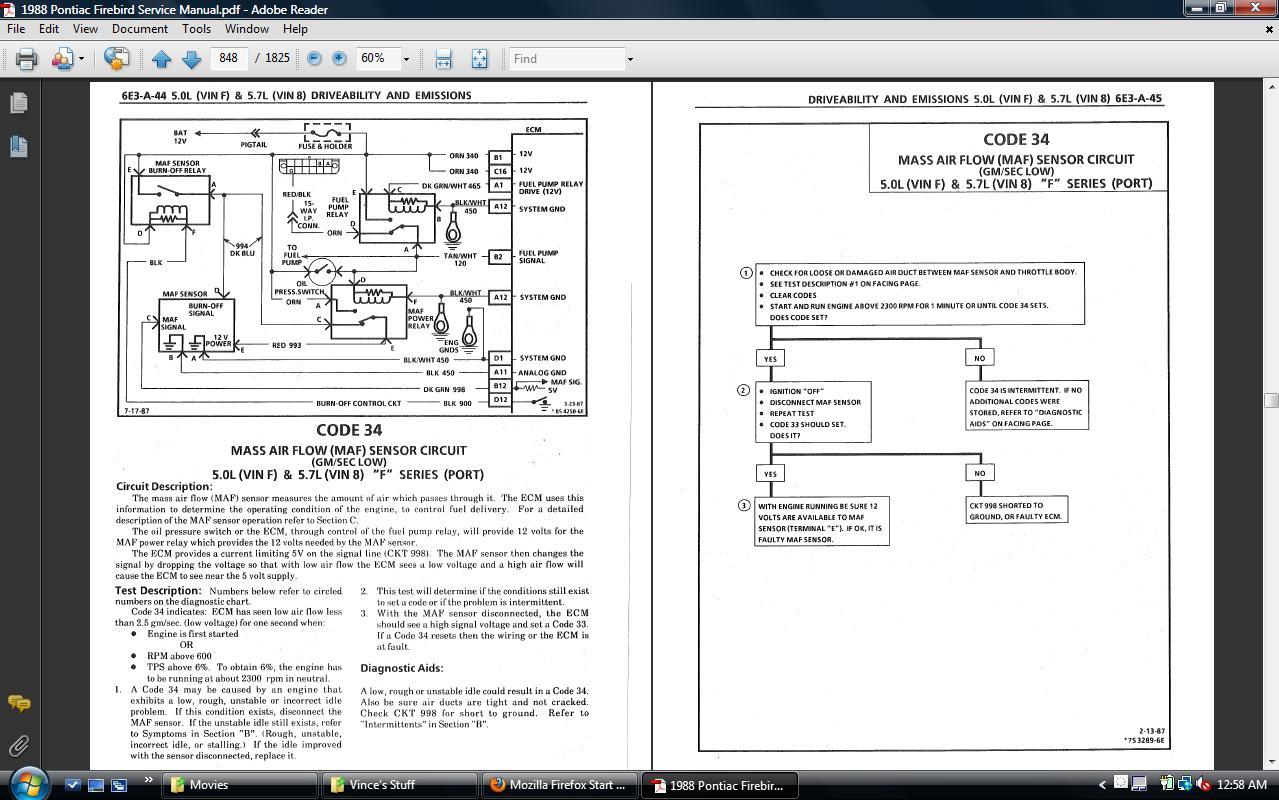

Attached is some info about code 34. Take special note of car throwing code 34 when MAF is disconnected (wiring or ecm problem).
Pretty sure you don't have a MAP sensor.
Check the top two wires of your TPS, it should be at .54V at idle.
Check the resistance of all the injectors, should be around 16 ohms.
Check the fuel pressure, should be 42-47#.
Hope this helps.
