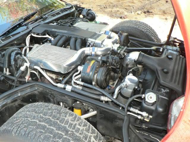

The intercooler is just before the throttle body:

That's pretty packed under there.
Looks like your MAF right after the air-filter.
You said you replaced the MAF a couple of times, so that eliminates some of the possibilities. When your ECM sees the MAF output it doesn't want to run.
It would seem that the MAF output is being skewed severely.
If you can watch your MAF grams/sec output at idle (if you can keep it running that long), that might be revealing of the problem.
If the MAF output is too low, or zero, then you could very well have good sized vacuum leak.
With all that plumbing in there it could be a lot of things from a loose connection to a crack.
You could try plugging all of your normal vacuum lines to include the PCV and brake booster to try to narrow things down a bit, and point towards your turbo plumbing or something else.
