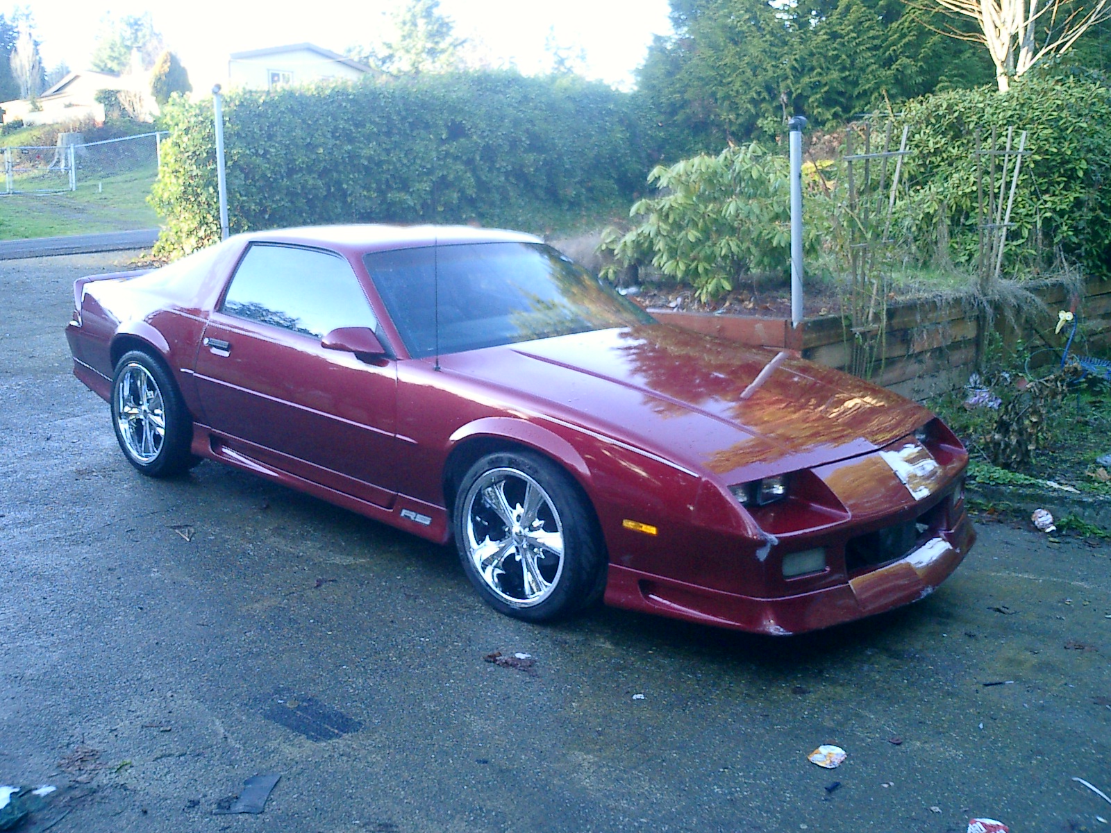

Hello, My Son AJ lost his best friend Terry who owned a 1991 Camaro that we need to get running right by March 4th in time for Terry's memorial at Bremerton MotorSports Park!
It starts off and on, replaced the distributor module, plugs, & plug wires but it's not starting again. Terry's camaro will lead a pack of his friends cars for a couple laps at the track. We need to have it running by then but we're all stumped???
It has to be something simple cuz it does start here and there. Any advice from the experts who have experience with this sort of issue? HELP us please!
Thank You

It has an automatic and it does turn over, but no spark and no fuel. The kids hot wired the injectors on the carb but they did NOT spray any gas.

Thank you for eveyone who offered advice and wisdom on this. It turns out that the distributor was going bad. Something to do with a coil pick up, or that thing under the rotor in the dist.
