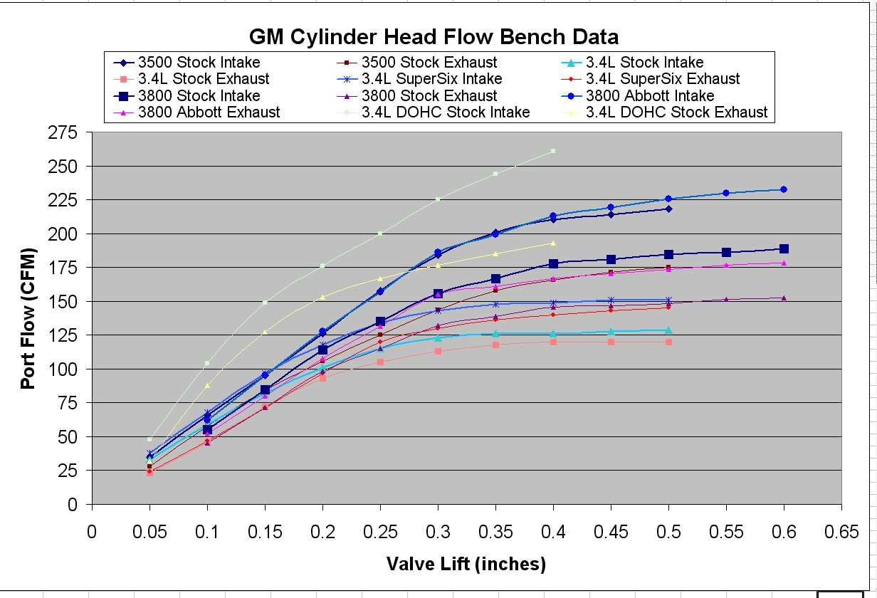

yeah those are the 3900 heads , but check out the 3.4 dohc heads they make the 3900 heads look bad

265 cfm intake at .425 lift
and about 190 cfm ex at .425 lift

4v heads have a big advantage over 2v head design.
Believe me, I'd rather GM get the next engine and go with a 4v head design, much better flow at low lift and better velocity everywhere.
