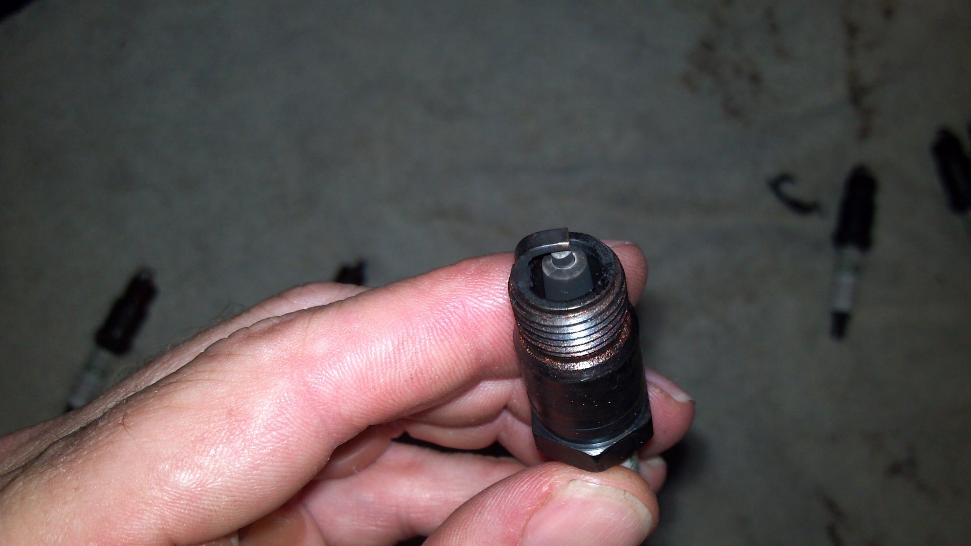

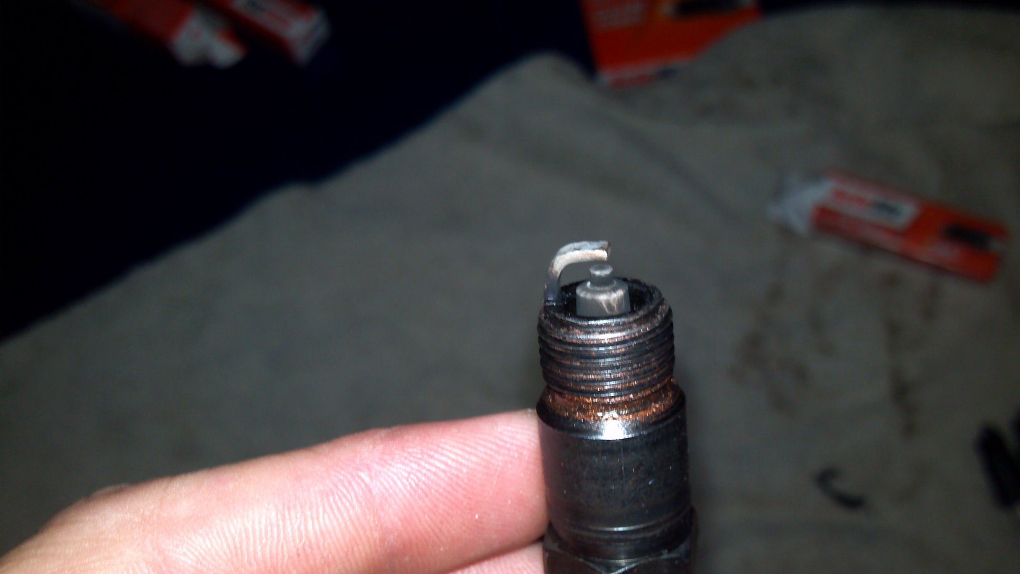

Old Aug 26, 2015 | 06:56 PM
bamaboy0323's Avatar
Joined: Apr 2014
Posts: 148
From: Carlisle, PA
Re: Surging/hunting idle
A few pics of my spark plugs.
Well ive seen worse plugs but those are definitely black. I would try at least the next step hotter plug. And if plugs are still black (but i doubt this) try the next step hotter. If u still have the old R45TS plugs no reason why u couldnt give them a try - maybe clean and gap them first though.
