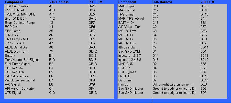

I have a 92 rs tbi 305/m5), just bought a complete tpi system(92 z28 5.0/m5), H/C/I. wiring harness and ecu(730) My biggest problem right now is finding a pinout diagram for the 746 ecu... does anyone have this diagram??? I've seen the swap guide and there are no wire colors..I'm looking for something like this
https://www.thirdgen.org/forums/v6/4...m-pinouts.html
but with the 746 ecu instead. please help!!
check it out
and here http://www.chevythunder.com/199092_f...227730_ecm.htm

that covers the tpi (730) I need the 746 ecm which is the tbi ecu so I can splice everything into place
http://www.chevythunder.com/1228746_ecm_198992_tbi.htm
