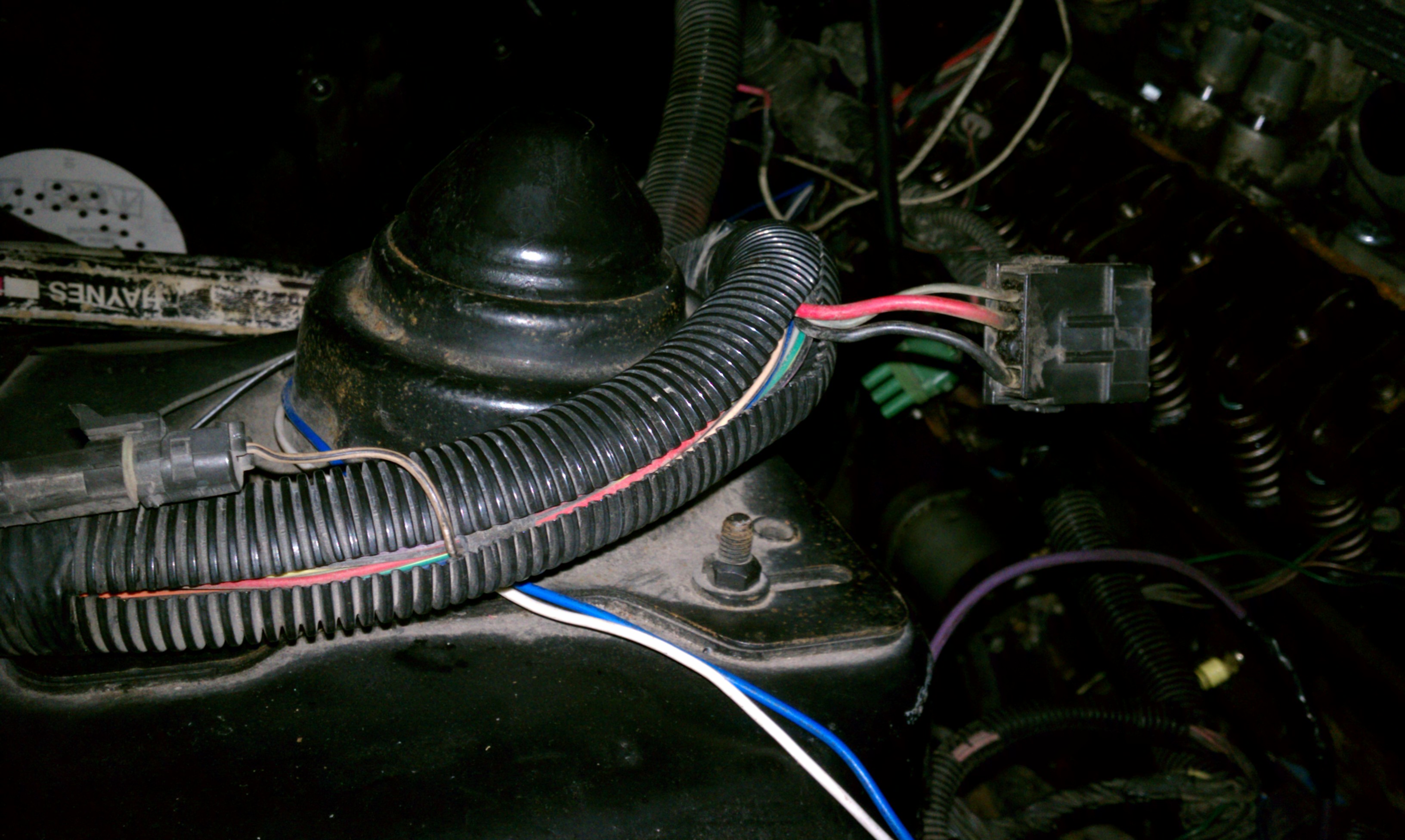

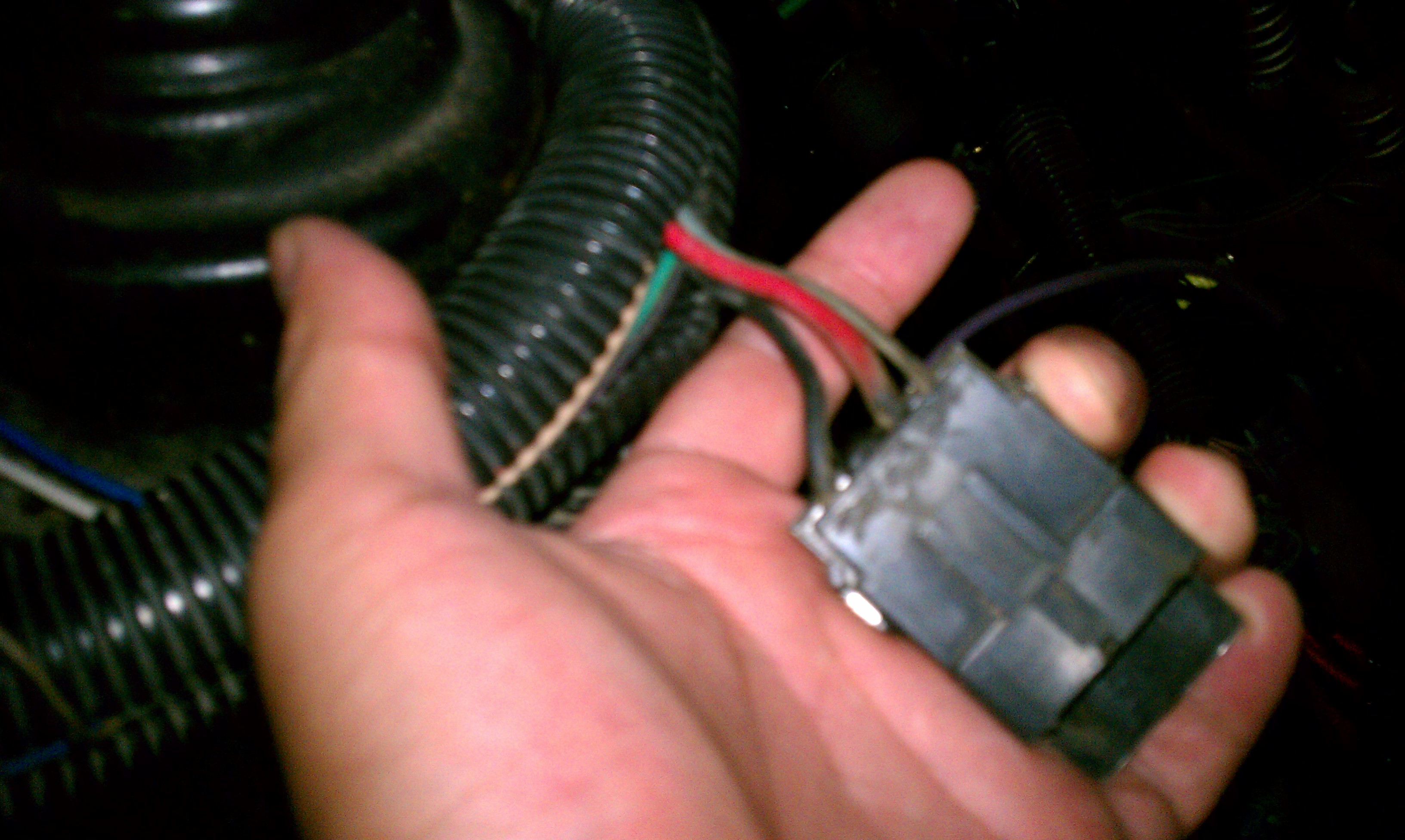

Cannot figure out what this plug belongs too!! PLEASE HELP!
92 g92 5.0 tpi
just wondering what this is???
would anyone know>>??
thanks
Attached Thumbnails Cannot figure out what this plug belongs too!! PLEASE HELP!-plug1.jpg   Cannot figure out what this plug belongs too!! PLEASE HELP!-plug2.jpg

Re: Cannot figure out what this plug belongs too!! PLEASE HELP!
I have the diagrams but I just can't seem to see this ?
Is your car currently running? The wires look like the color wires of my alternator plug.
Also sir[Chris] from the picture it looks like that plugged is fried, is that so?
I believe it is for your HVAC blower fan harness, its not fried, GM packs that one with grease to help seal it and fight corrosion.
Awesome, so that is for A/C?
I didn't have that on my tbi harness ..
I connected the fan and fuel pump to see I'd they would prime and nothing , my fan was set to turn on with the key in run .. but nothing , my car cranks and I have power but I haven't connected the smaller wires to the harness yet.(i cut the loom from behind the c100 the guy didn't want to give it to me)
Is it possible for one of the smaller wires to activate the fan and pump?
Tbi to tpi , kept the fan harness from tbi, and wired in the fuse to the new harness.
Can I run the fan to the blower plug?
Again thanks for the help
