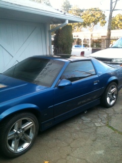

hey there brothas.. well im doing my mechanic work my self the old american way... well i have a 1989 5.7 t tops, i took the runners and plenum off and when i got to the fuel line and the 4 10mm bolts they are not moving!!!! i tried soaking it with wd40, buying a socket adapter for my 18v dewalt impact gun thinking the little hammer-like impacts might free it up.. i dont want to break it let alone strip it.... any suggestions guys???????? ill post pics of the bolts soon heres my car btw proud owner since high school im 26 now
