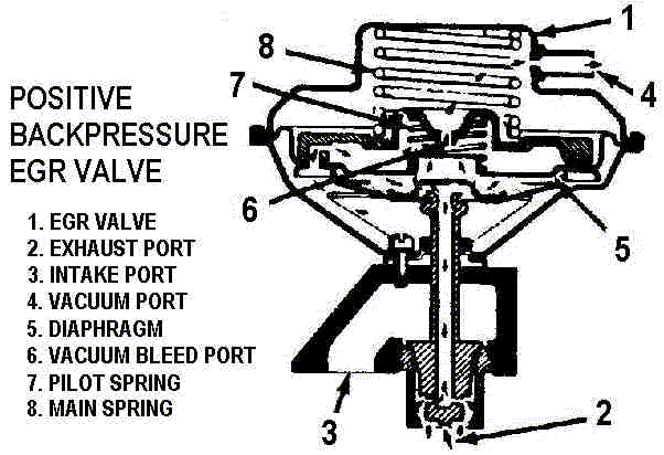

The replacement EGR may be the incorrect type:
The EGR solenoid may also be connected incorrectly or faulty.

I just looked at mine and the # on the original has a "N" (negative)on the end of it. It may have a number on the new one with a letter on the end indicating the type.Look at the old one and see if they match.
Here's where I retrieved some info = http://www.chevytalk.org/fusionbb/sh...php?tid/258416
