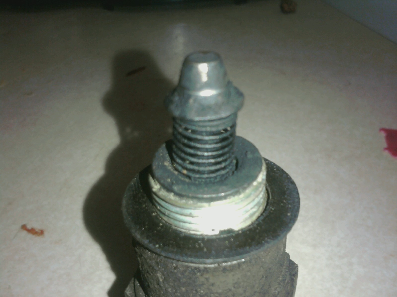

I pulled one of the IACs today and this is what it looked like. (Couldn't get the other one because I'm not at home and don't have the right wrench) Is this an excess amount of carbon? I'm sure the other one is equally as nasty.
Vacuum tested the EGR and it seems fine.
Am I supposed to relatively easily be able to pull/push the pintle in/out?
