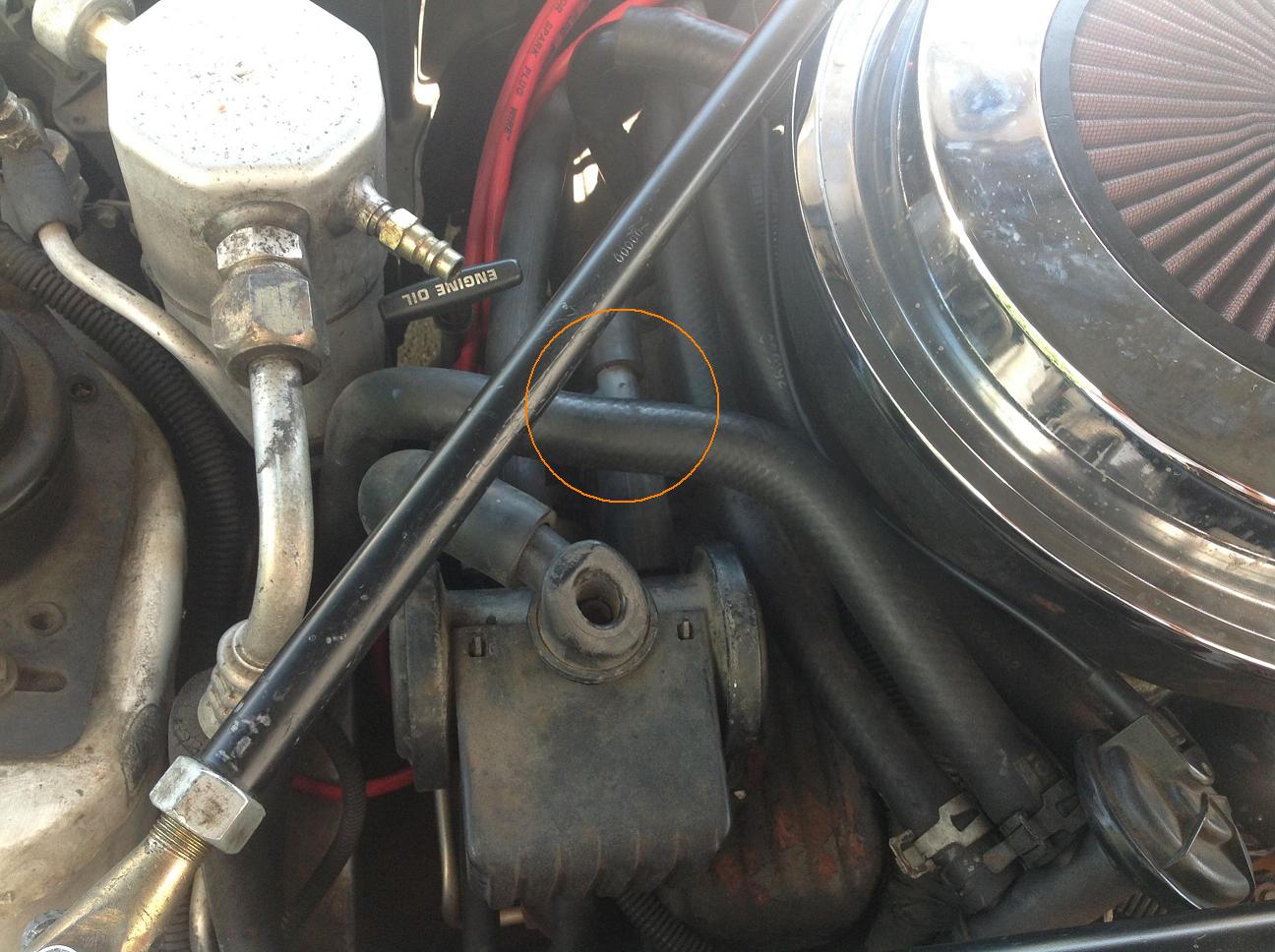

Starts every time when the vacuum cable to the EGR valve or to the intake from the EGR solenoid.. Basically anything in that line.. It starts rough tho..
I checked every single vacuum line and theyre all good.
Also when I do get it started, there is a huge leak from the IAC valve area (from the inside of the TB of course). Sounds like a loud vacuum. I know you guys said theres supposed to be a leak, but it bogs the car more when I spray carb cleaner there than when I spray carb cleaner right down the TB. Sometimes I can get it to go away when I put the air cleaner on, but sometimes its still there. It definitely wasnt happening before when the car started fine. also when I start the car it smells very rich.
Does this plus the code 54 indicate bad fuel injectors maybe? I sprayed carb cleaner on top of them and there was no bogging though. It doesnt seem like the fuel pump is out yet, especially since it will run forever when I do get it started.
The IAC valve connector is pretty ****ed up now. Theres some plastic stuck in the IAC valve actually.. But the metal is still good.. It still tries to push the needle/pintel in the IAC valve in diagnostic mode. In fact it never stops clicking, it keeps trying to push it out and never stops

Well Im completely confused.. I got it to start every time and also eliminated that loud vacuum noise/leak by just messing with all the vacuum lines again.. Mostly just plugging and unplugging them.. I drove it for 30 min hoping maybe the ECM is getting used to the IAC or something. It ran like a dream, better than ever, especially with the new TPS... Came back home, and now it cranks but wont start. Vacuum lines all look good still.. Im lost..
Oh yeah it wasnt running all that rich when I was driving it. I popped the hood before I turned it off. Didnt smell very rich at all. There was no vacuum leaks, or if there was, nothing audible. Now I try to start it, and after just 5 cranks, it smells super rich, inside the car especially, but under the hood and outside too. I tried with gas and without, since earlier it seemed to start better without hitting the gas, and nothing worked

I circled the vacuum tree I was talking about. It's the next thing away from the air cleaner after the heater vacuum setup that you were describing.
Also what does it connect to? That thing under the circle that's above the passenger side exhaust manifold and kinda over the valve cover too.
I will get the oil, fuel injector treatments, and the Seafoam
Attached Thumbnails Cranks forever, doesnt start, eventually starts right away-image.jpg

Well I unplugged the MAP sensor and it started up a little faster, instead of cranking for 5 seconds it cranked only for 1 second. Starts every time but runs super super rich all I smell is gas. Real strong too. Inside the car, outside, all inside my garage that happened to be open (car is outside).
I tried to clean the MAP sensor with electrical contact cleaner. Plugged it back in and it starts every time, although sluggish, but starts after only 1 second of cranking. Im hoping its just a bad MAP sensor. Ill get one soon and update

Yes good thinking on the map sensor. That would definitely describe some of those symptoms also. And it would make your service engine soon light come on intermittently. Think you may be on the right track....and the vacuum hose looks like it goes to the emissions. You should be able to follow those hoses to the smog pump and to the exhaust manifolds.
