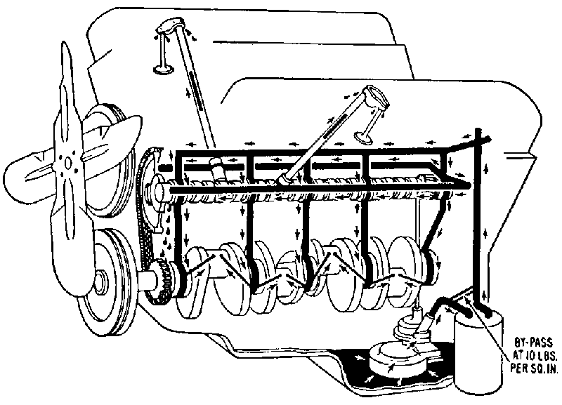

There are a number of locations a oil leak could come from at the back of the engine.
