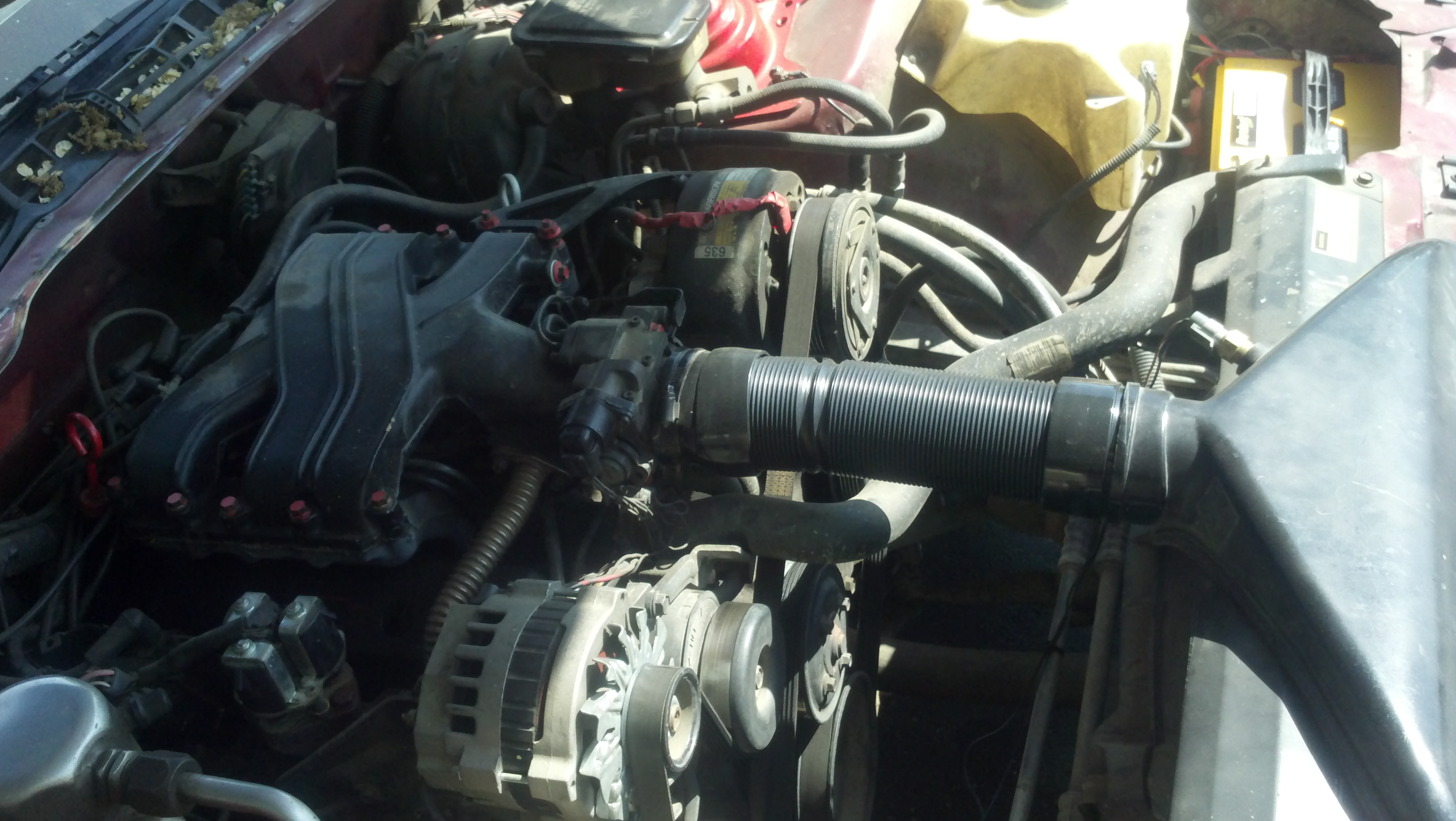

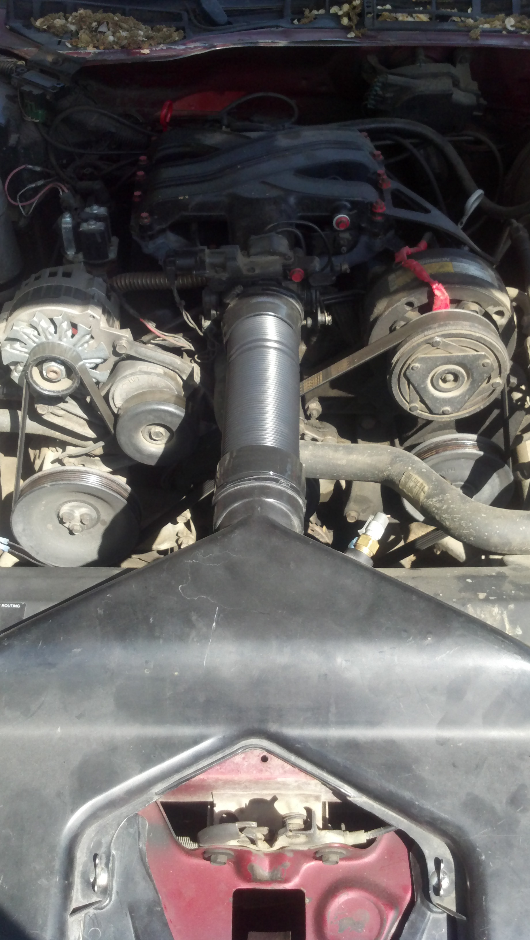

i have a 91 camaro v6. i have to smog it this yr. well this month
it passed just fine 2 yrs ago, but since then ive changed the way the air gets to the motor, i removed the stock air canister and have a iroc air box from a tpi motor, the only thing is i dont have my pcv valve attached to the air duct anymore. im almost positive ill fail a visual inspection, and i doubt a breather would help me pass. but would it? or do i need to reinstall all the stock air intake stuff?
and im in lame *** california btw
Attached Thumbnails smog question-2013-04-12_15-08   smog question-2013-04-12_15-08

How is your PCV system put together now? A strict inspector will probably call you on it not being connected in the original manner. I take it it's just the fresh air tube that's not hooked up. It connects to the TB on the TPI.
