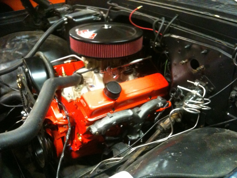

I just sold a 1969 C10 I built. Had a mild 350 with a little cam, it was very fun on the street with a wide ratio muncie behind it.
I used a factory numbers matching q jet, rams horn manifolds, and a tiny balancer. It looked just like a 327.
Even got 16mpg with 3.73 gears.

Re: I would like to build a 327
That's a sweet truck, looks like my stepside. I can't wait to get it back together. it's down to the frame since I'm doing a frame off, and lowering it 2.5" in the front, and 4-5" in the back.
My 86 is down to the frame as well for a frame off... just got thru spraying the frame with epoxy primer, and have the front cross members, and suspension back in. working on putting the rear back in, and my hood/fenders, and underside of the cab i sanded to bare metal and epoxy primed them too. another week of rain expected here, so i'll have to wait for any more body work/priming
wish i had a camaro too
