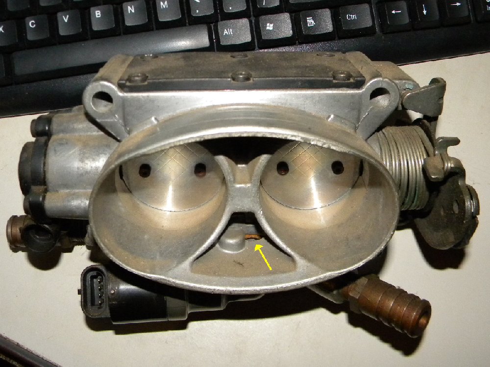

There's no way to guaranty that cleaning the IAC will solve the problem. However, if the IAC is dirty and sticking or the passages are plugged, I can guaranty that nothing else you do will solve it. In short, you might as well clean the TB and IAC anyway, and it MAY solve the problem.
If you can't get the IAC removed, you might try to blast some cleaner through the air passage hole in the bottom center of the TB. I just pulled a dusty spare off my shelf identified the hole with an arrow:
It would be tough to accomplish, since LT1s don't like to run without a MAF signal, but it might be most effective to do this while the engine is running and intake bellows is removed.
