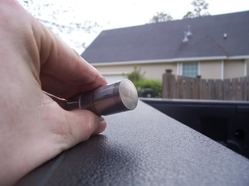

Just because of the stories of counterfeit and/or outsourced chinese lifters rebadged under major brands that may or may not have questionable metallurgy... I prefer the old GM style lifters.
I had a lot of issues with v1.0 and v2.0 of my build, and had to abort TWO SEPARATE BREAK INS plus the third time I managed to miss a rocker setting valve lash and I decided to abort about 10 minutes into that to go through it again. It had maybe 15 total minutes of run time, stop and start, lots of distributor adjusting, some bad spark plugs after sitting for 6 months in the elements you name it I had an issue with it.
And the lifters held up fine. Every time I aborted I pulled them and compared the wear patterns on each lifter to make sure none were cupping before I tossed them back in (on the same cam lobe, obviously) and I had ONE that was doing something a little odd after the first 5 minutes of run time but settled in nicely.
I re-lubed them each time, but it was the comp red lube that everyone says does mostly nothing... who knows. It worked for me. Of course I used rotella and ZDDP supplements and everything and I was SUPER paranoid about cam failure, I almost just bought a new cam but after looking at the wear patterns I decided nothing was broke just yet.
Then immediately after the first time around the block after I got them totally broken in, I got a crack in one of my .060 over 010 block(never again...) cylinder walls from them being too thin and got total milkshake going on, and I pulled them AGAIN and they all looked great.
The point is, and I had read this a while back, those "Hard face" lifters with the different metal at the bottom were the traditional GM OEM lifters, and only one company makes lifters like that, and it's therefore easier to verify that they are in fact quality, american-made lifters. Around the time I got my cam there was a rash of cam/lifter failures and many were blamed on one of the companies ramping down production leading to a burst of overseas lifters being bought to meet demand. By the time I bought mine, about a year or two after that, these were the lifters included with my comp cams kit. But because tehy're so unique, I know they're not the normal lifters sold by comp cams. So I imagine that after all the failures they had to become more selective about which lifters they sold until they could meet demand themselves, and so I got these lifters with my Cam/lifter kit even though they're not really Comp lifters.
Long drawn out story with a lot of weird caveats... but I know these lifters can deal with hell, and they're still working great in the car now, 5 years later, and they had a real rough break in period. So Im a believer in these. If you can find the ones with the different bottom on them, they're good in my experience. I see them referred to as "Delphi" lifters from time to time.

You can see the picture of the lifter that looks exactly like mine. So if I were to do flat tappet again there's no question which I would use. They are available on ebay and other places.

It's almost impossible to know what all went on before when people show their catastrophic failure pictures on line. I suspect improper break-in is behind most of them. Improperly matched parts is probably close behind.
