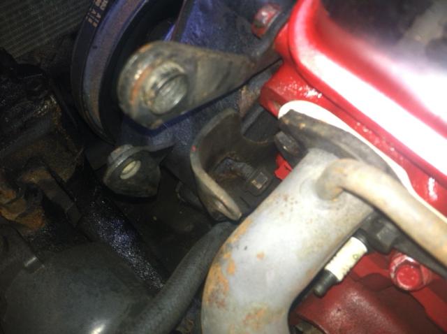

and to MrBranados, pictures would help greatly if you have headers and no A/c, i THINK i got it but im not sure if its right considering the one bracket wont bolt on because of my headers.

OK I understand the aggravation factor. Dealing with some brutal cold here too. And a headache for a week now, I may get a lil grumpy lol. Did you delete the a/c? because the high bracket for mine wouldn't go around my headers, I had to cut the part off that went to the second from the front bolt. Then you need to make a spacer to make up the difference between the header flange and the old manifold if yours didn't come with one. My cars in the shop( 10 months now for paint ugh) but I'll be visiting her tomorrow. I can get pix of how I did it, maybe. does this help? Note the top bracket for a/c goes behind the one that bolts on the front of the head. It will cause spacing issues if removed. I hope you have the spacer that often gets lost.

ok yea that cleared some confusion up, i have it all on now but without that high bracket for the ac, because like you it wont clear my header.
and yea i have no ac, and no smog pump, leme see how u cut it/spacered it to fit, shes almost done i wana hear her start by sunday!

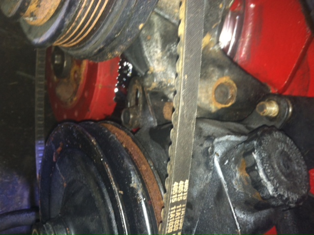

here some pictures of what i have so far.

Spacer is like a 3/8 thick washer that goes on the studded bolt behind the top of the pump. If you don't plan on using the a/c you can get a bracket from a pickup. I may even have one still in my garage I'd send for a few bux to cover shipping. looks like this. FYI still on that same search I suggested you do in Google images and these are coming from it.

and yes i DID lose that spacer,(well i didnt lose it i just couldnt find it at the time, im sure i have it), i noticed something wasnt right when i tried to put a bolt in it... BUT, if you look at my top pic, i used a stud with a nut on it as a spacer, was going to put a second nut on after the pump bracket.... looks okay to you right? i was thinking worst case scenario if its spaced out to far i could just shave the nut down a bit...
