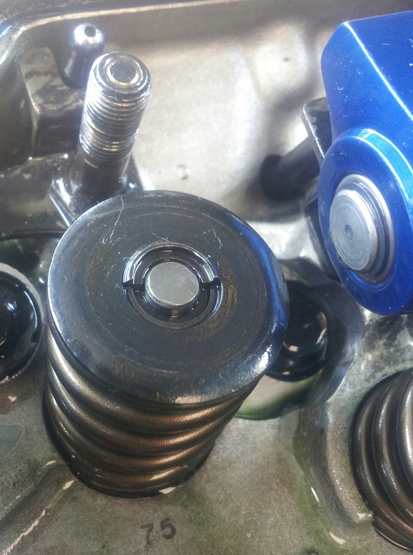

Hey guys I got my 496 Gen 4 Stroker running today and upon breakin after a couple of minutes of run time i noticed the #2 Intake lifter is not spinning! I immediately shut down and checked the lash which is set at .015" b/c of my aluminum heads. Its a Comp tl292a-8 .635/.637 262/270 @ .050 cam with all new lifters and everything. I'm using brad penn break in oil. I called Comp and their only recommendation was to back the lash off .005" and see if that frees it up. When i checked the lash i pulled the push rod out and i could see the lifter in there with some residual oil at the top of it, but its clearly not spinning. All other lifters are spinning great and the engine sounds good but until i figure this out i'm going to keep from running it. Has anybody on here ran into this before and what did you do to fix it? I'm trying to prevent from removing the intake manifold and making a mess if i can such as using a magnet to try to pull it out of the bore and turn it or maybe using compressed air through the push rod? Here are some pictures of whats going on.
*Tried blipping the throttle from 1500-3000 real quick earlier too but nothing
Attached Thumbnails 496 Stroker Lifter Not Spinning Upon Breakin HELP!-1508976_660002277353473_638824323_n.jpg

Sounds like the typical modern problem w flat-tappet cams... this is why most of us go roller whenever possible...
I don't think there's any way around pulling the intake, if you're serious about actually fixing it.
Pop that lifter out of there and see what the bottom of it looks like. Make sure it's completely free to spin in the bore, I.e. that you can easily spin it by hand. Hopefully it doesn't already have a "bar"-shaped witness mark worn into it; if it does, it's already toast. If it doesn't, take some about 400 grit sandpaper, and gently sand the face of it, from center to the edge, like the spokes of a wheel; emphasis on "gently'; just enough to roughen up the surface just enough to where it will get a grip and not want to slide on the cam. If it's tight in the bore, sand out the bore gently with the 400, being careful not to get any of the grit onto the cam (like, grease the lobe real good with white lithium or something, and then wipe the grease back off when you're done). Clean up all the grit out of the bore when you're done. Put it back in with some moly grease on the lifter face, and plenty of oil in the bore.
.015" sounds about right for that cam; IIRC that series wanted .022" hot, and .015" cold will give you about .021" hot so that should be fine.

Going to try these things today before i proceed to take off the intake manifold:
Check the rocker arm cup to see if its rough keeping the pushrod from spinning
Lube the pushrod ends with some assembly lube
Back the lash off .005" (recommended by comp)
Check orientation of lifter by visually seeing snap ring, crank engine for a VERY short amount of time and see if it changes.
I've talked to almost every cam manufacture and that seems like the first things to go after before taking the intake manifold off. Two different guys said to go ahead and break in the cam for twenty minutes to get everything nice and hot and see if its not freed up by then. But its not their car or engine, to me thats just asking for trouble

Alright guys I have an update.
I checked the rocker arm cup and it appeared fine minus maybe one little spot on it smoothed it out and even put some assy lube on it and on the push rod tip. Set the lash to .018" and fired it up. The rocker arm was getting plenty of lube up to it, equal to the other 15 rocker arms but the push rod is mostly static with occasional rotations. I proceeded to break in the cam but once it started getting nice and hot it started splashing oil everywhere with these valve covers being cut open. I would say it ran a solid 10 minutes and got up to 150 degrees. Should i be out of the ballpark? If its getting an equal amount of oil to the rocker than that must mean the lifter is rotating. I'm guessing the guide plate might be rubbing it while its under a load just enough to keep it from turning much. The only other thing which doesnt seem rational is that the lifter is stuck in the correct position to get oil through the lifter orifice. Any thoughts? As soon as these new valve covers come in i'm going to run this thing for another solid 20 minutes.

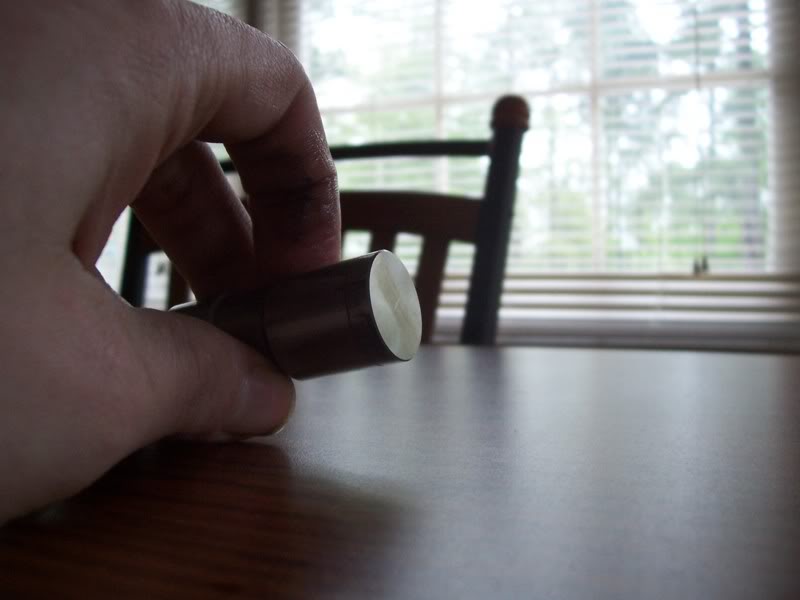

I would probably ditch the lifter and replace it as long as you can turn it by hand in the bore. Lifters are cheap, this one isnt working, see if another will fix it. The damage may be done but it's not a huge expense.
This is a lifter that came out of my 350 back when I had about 2 minutes of run time on it.
I had to abort the initial break in due to an unrelated issue, and since I had it apart I checked all the lifters. All had a nice round pattern on them except this one. I drenched it and the cam lobe it was on with cam lube and all the other lifters got a fresh coat of break in lube too.
Works fine now.

Looks exactly like my lifter. I went ahead and ordered a new lifter but its not here yet. My car also sits outside so today was the first day i had a chance to get around to working on it. So here is what I got. It felt really smooth in the bore and came right out. I'm going to pull the plugs out (case of hydraulic lock from pulling intake), put the new lifter and distributor in and crank the engine for a second or so and see if it spins in the bore. If so yay if not then back to the drawing board.
Side Note: I'm officially a licensed aircraft engine mechanic! Got my Powerplant license Saturday. So i'm an A&P
Attached Thumbnails 496 Stroker Lifter Not Spinning Upon Breakin HELP!-camarolifter.jpg   496 Stroker Lifter Not Spinning Upon Breakin HELP!-camarobore.jpg

Alright guys got it running good yesterday i broke in the cam finally. The original lifter i tried using again did not spin while it was running even though it did cranking so i was able to swap lifters using two magnets and a hole just barely big enough on the opposite side cylinder head. (I felt like a boss) That lifter also did not spin at FIRST but i rotated it 90 degrees and fired it back up and like a dream it started rotating real slowly then started going faster so after thanking god i broke her in. Going to retorque heads, change oil, fire up and get her nice and hot to break the rings in and then shut her down and adjust the valve lash and hopefully be good to go! I'll post videos later

Never a dull moment. Changed oil in it Monday afternoon and was checking through some things before i fired it up. Found this, no idea how it happened other than that my new valve covers was rubbing that particular rocker arm a little bit (#1 Intake). Good thing the other keeper held on. What could have caused this? I'm 99% sure it wasnt like this before i fired it up. I guess my next course of action is to get a stud mount spring compressor and inspect the valve and keeper. Just make sure its at TDC right and the valve can't go anywhere?
Attached Thumbnails 496 Stroker Lifter Not Spinning Upon Breakin HELP!-resize.jpg
Old Jan 22, 2014 | 10:53 AM
redneckjoe's Avatar
Joined: Sep 2011
Posts: 2,080
Likes: 34
From: Spring Hill, Fl.
Car: 87 iroc-z
Engine: 454
Transmission: th350
Re: 496 Stroker Lifter Not Spinning Upon Breakin HELP!
glad to hear the lifter worked.
nice catch on the keeper. that could of been really bad.
