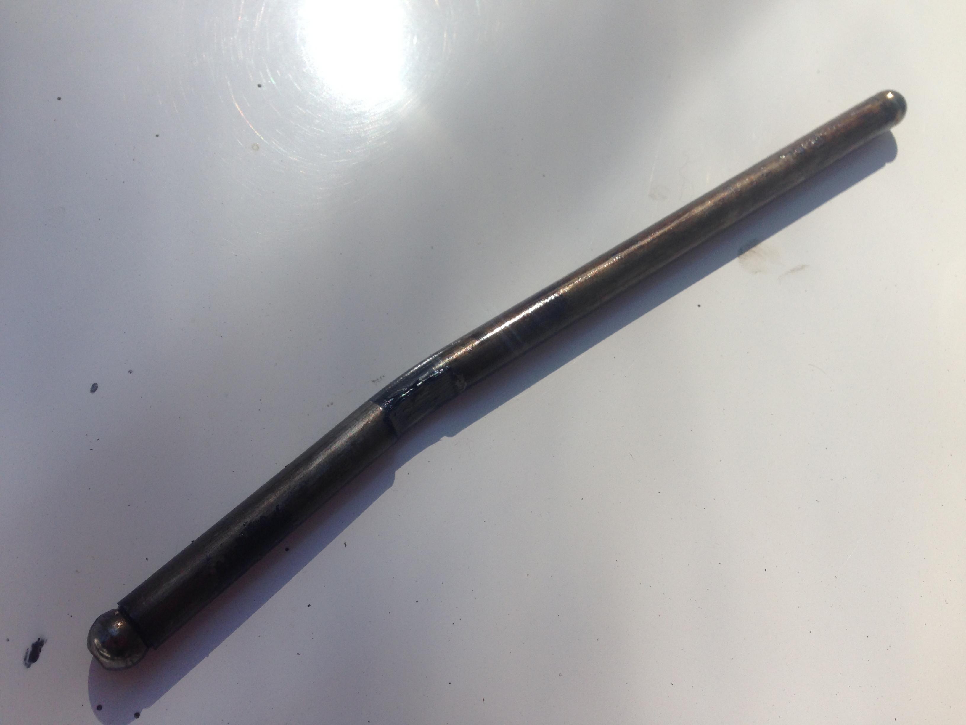

Okay so today I checked the oil and there is no glittery metal in the oil. I popped the valve cover on the side of the cylinder that has been giving me issue and found that one of the rockers were completely off and one was partially off where it was supposed to. I removed the rockers and found that two of the pushrods are bent.. what could have caused this? Do I need to take off the intake to check the lifters? Also is the car safe to drive with both rockers and pushrods removed?
Now you need to check the rocker studs and make sure they're not pulled out of the casting... lay a straight-edge across the top of them, and if any are up higher than the others, esp the ones with the other damage, then they need to be repaired before putting new rockers & push rods in.
Probably wouldn't hurt to verify that the valve springs don't go into coil bind at full lift; since the engine "has been completely rebuilt", there's no telling how well/poorly that part of it was set up, what cam is in it, etc.

To check the valve springs, do I need to remove the intake manifold to check the two lifters that may or may not be damaged? I mean if I can just buy two new pushrods and reuse the rockers then wouldn't that be okay? (taking the rocker studs are already aligned)
