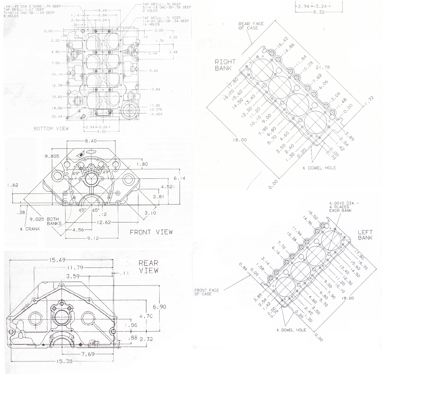

Not real adept at searching these threads so apologies up front if this has been asked and answered ad nauseum. Does anyone happen to know the correct cam centerline to crank centerline distance on the 305 TPI engine? Thanks in advance for the help.

Try this

Perfect!! Thanks.
