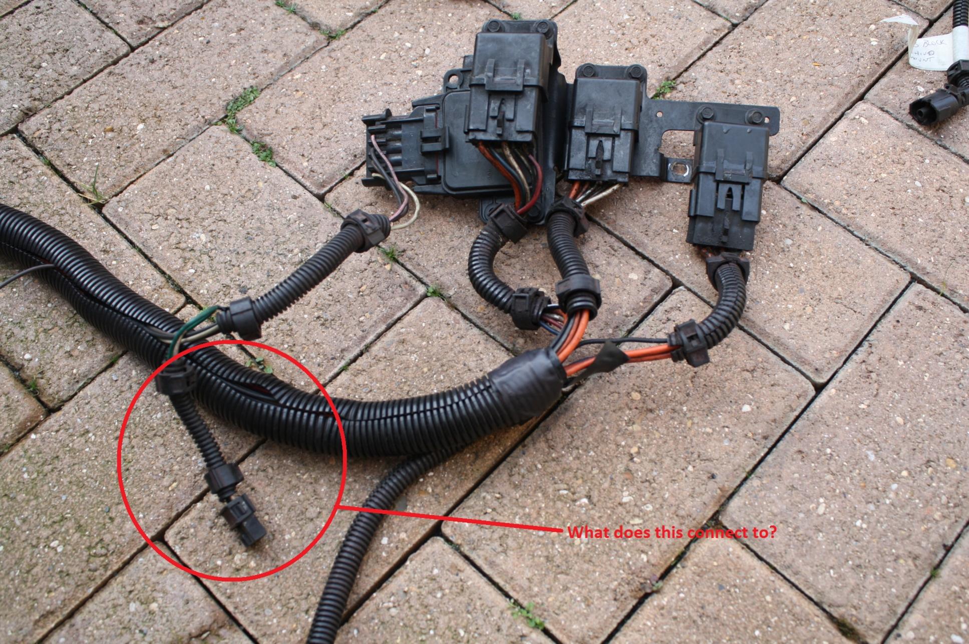

This is the 1st loom that was in situ:
Engine/ECM harness:
1:Can anyone help with these:

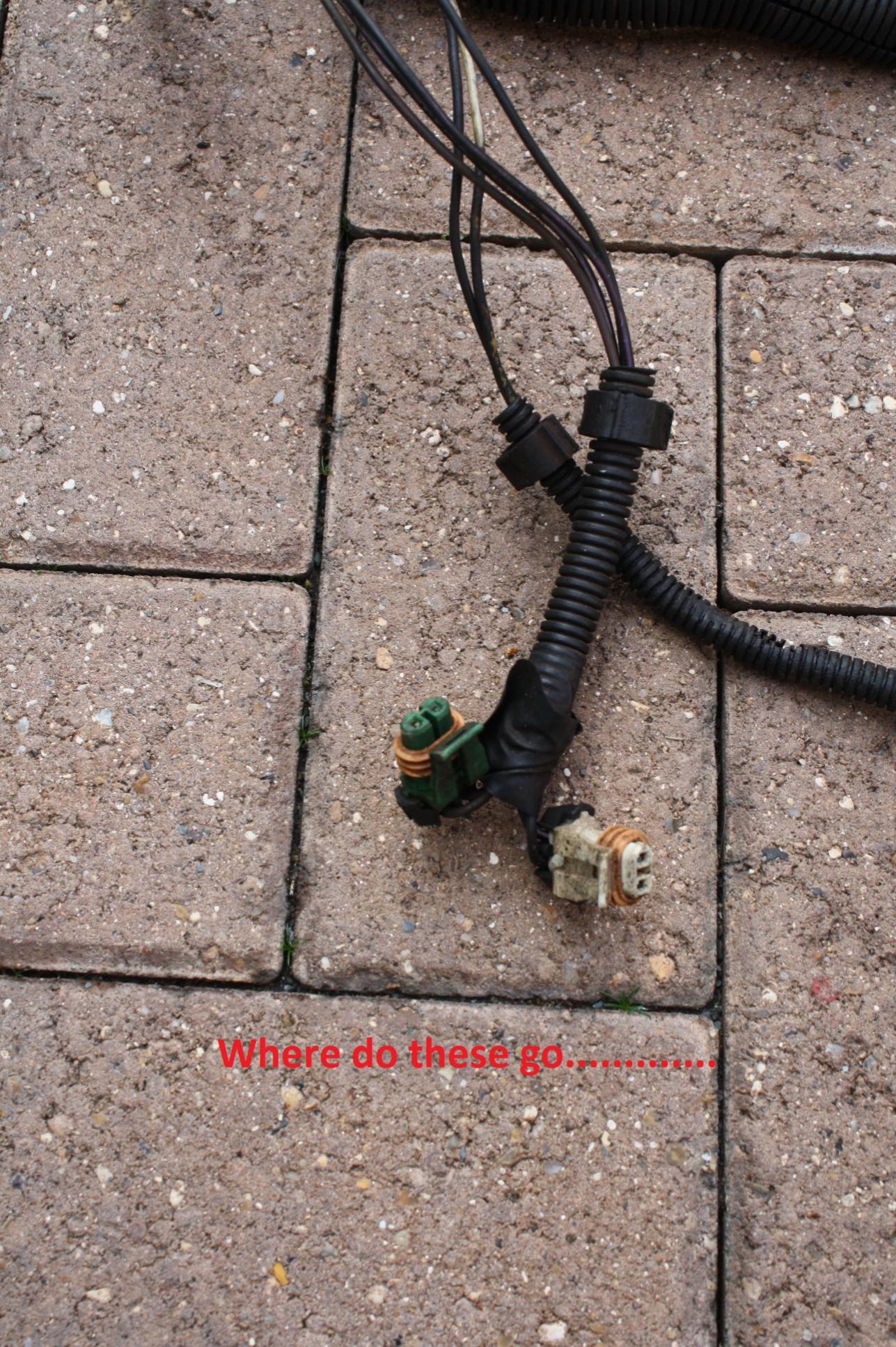

2: Where does the this white plug attach?
TBC.............

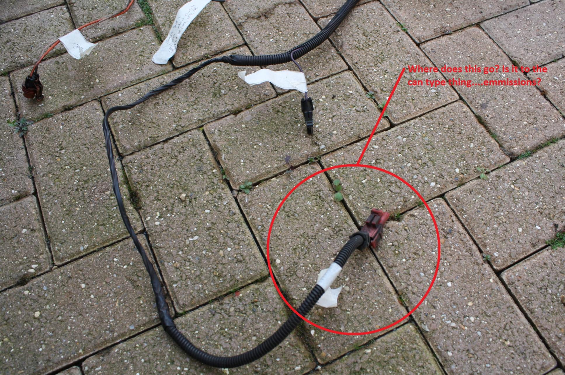

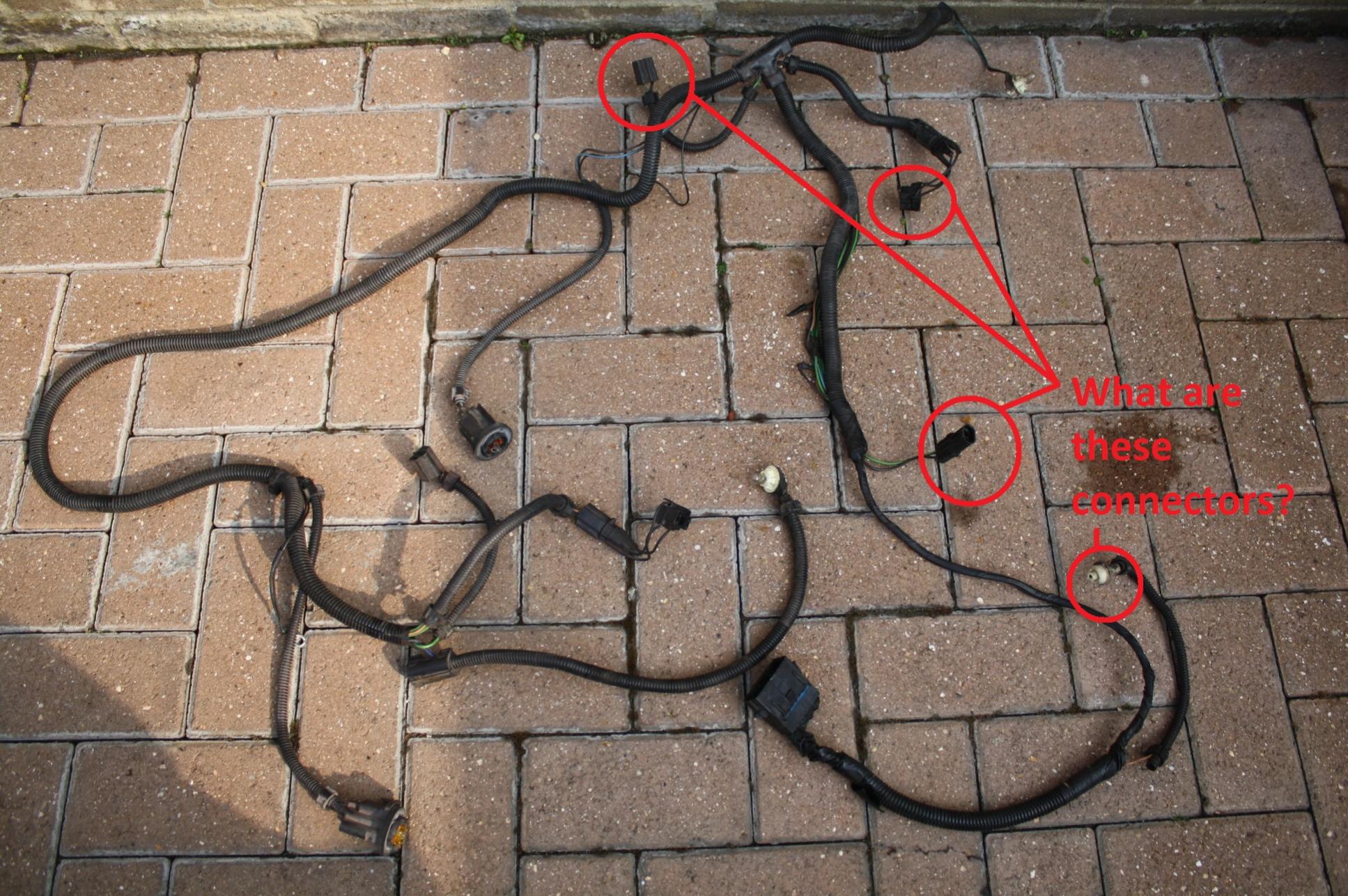

3.This connector block was on the firewall. What is the connector?
4. This was laying down near the ....??is it a carbon can?? Emmissions??....behind the driverside headlights. Is it where is goes and what is it for?
5. Look at the poor excuse I found for a Distributor to Coil connection I found!!!!

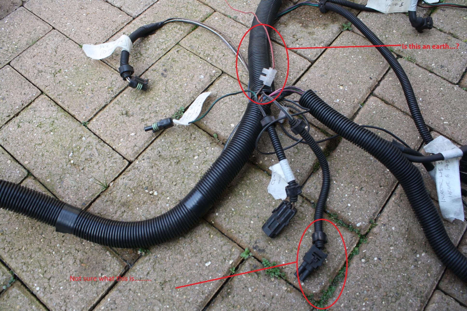

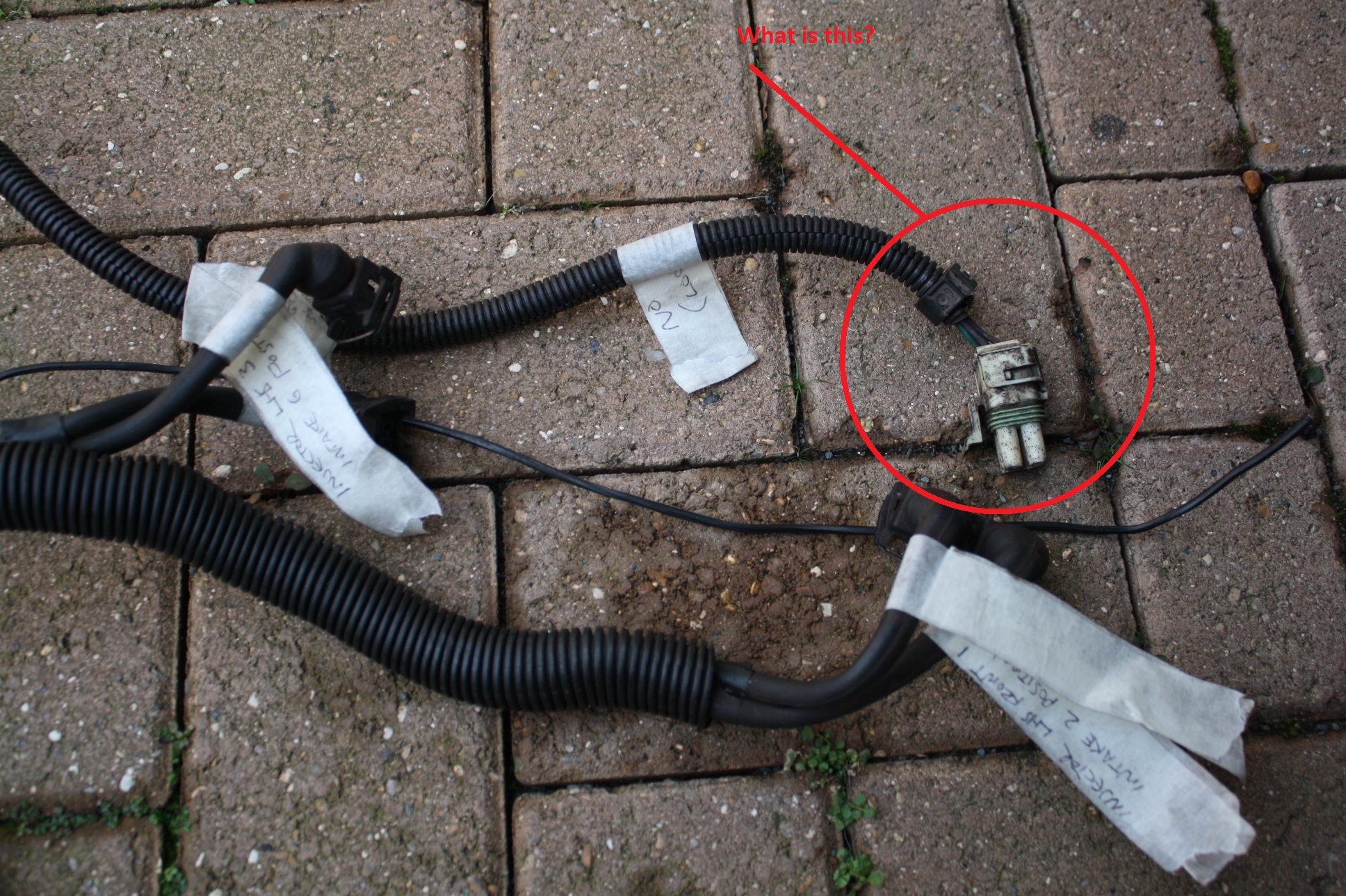

9. Not really sure about this whole end....again not connected to anything? Looks in pretty bad shape?
10. This is the other part of the loom that was still attached to the car via the split connector block with the screw in it.
11. One side of it looks butchered again......does anyone know what the bare wires are for?

Re: Help please...Harness mess!
Hi Kyle,
I don't know tham all, but will help get the ball rolling:
1:
Top - Looks like Oil Pressure guage wire, (Should be TAN wire )
Bottom looks like EGR relay plug
2: Auto Tranny
3: Connects to 2 wire plug on ENGINE harness. ( oil pressure and ?? )
4: Carbon Canister
5: Coil to Distributor. Yup, it's ugly ( ,... but it should work )

10: ENGINE harness
11:
Looks like spliced wire on Left is Ground
Top look like AC and possibly O2 sensor wire and temp gauge wire.
Yes; Right side = Wipers
Bottom right = 2 wire connector on ECM harness ( mentioned earlier )
* not sure about small 2 wire connetor in the middle.

15: hacked duplicate light harness. Use this to trace where your horn wire should be on the "full" light harness.
I can't be 100% sure,... but I know that many/most I've Identified are accurate. At least that should be enough info to get you started !!
