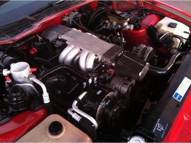

You sure my egr has an electrical solenoid? Looks like it's run by vacuum to me. No electrical connections, a vacuum line nozzle only.

My map sensor is there in front of the notch in the distributor cover. Here's a pic.

The ECM on yours uses readings from the MAP sensor to determine if the EGR is operating when commanded ; there is no direct sensor
( a EGR temp switch ) for EGR operation like there is on the MAF cars
If the MAP sensor was faulty you would have MAP fault codes 33 or 34 showing
If you have a DTC 32 you have a EGR problem
Best you can do is work through the DTC 32 diagnostics linked here
http://www.chevythunder.com/egr_code_32.htm
remembering you don't have the temp switch mentioned

Like the picture, your EGR valve only has one vacuum port. There is a solenoid located under the ignition coil that allows vacuum to the EGR valve when the computer commands it.
Removing the upper plenum is not that big of a job. Well within the range of the average do-it-yourselfer. After you remove all the bolts, you might have to pry or rubber hammer the plenum loose. And when reinstalling, finger tighten all the bolts completely in so that the whole assembly is nice and relaxed before you finally tighten them home.
