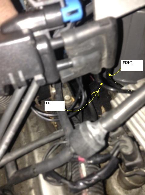

code 32 is the message for a bad EGR, mine was replaced and looks to be in good working order. the alternative to this is a bad ECM. my code is intermittent and after i clear the ECM it will come back on after a few days
here is what i know. the EGR valve
-itself was replaced and is working.
-the EGR passages are free and clear (not clogged)
-the solenoid is new
-temp sensor is getting 12 volts to it.
i am not sure the solenoid vacuum hoses are hooked up properly...pic is attached. for reference, the blue clip is the harness going into the solenoid
directly underneath it there is a rubber boot, the left hose goes to the EGR valve, the right hose goes to the intake manifold and provides the vacuum, how would i which connects to which port on the EGR solenoid??

so got back out there today and after some closer examination realized the guy who helped me install my EGR solenoid had the hoses hooked up backwards. reset the computer and sure enough the check engine light stayed off, idle seems a little smoother too but that's probably just in my head. didn't get a change to drive it yet but hoping it stays off. whats strange though is that the car ran fine for a few weeks with no engine light...it should have triggered at some point during those weeks if the ECM was not sensing EGR fumes. either way i'll drive it this weekend and see how it runs
