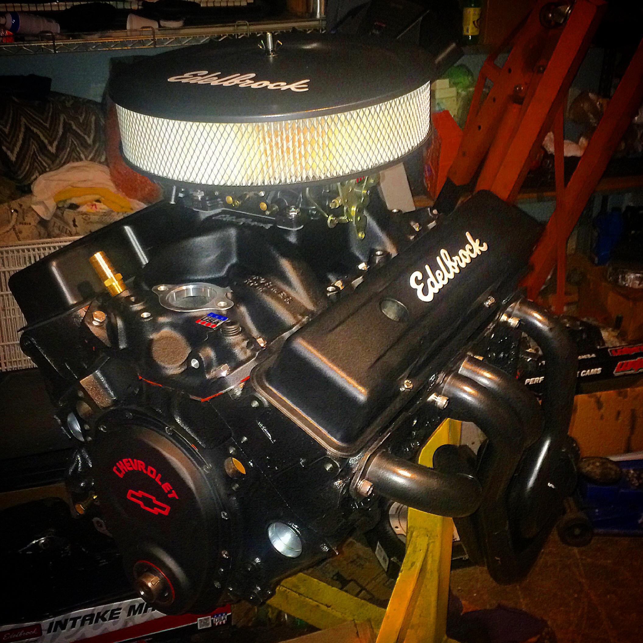

So after so long i finally got my l69 305 engine rebuilt (5-speed),
Now i need help wiring it up and knowing what sensors i will need,
And what wiring i will be able to delete, so far these are the after market parts i have bolted down;
Lunati 256-262 cam
Lunati timing set
Edelbrock non egr Performer RPM Intake Manifold
Edelbrock 600 carb
Edelbrock fuel pump
Edelbrock waterpump
Melling m-55hv oil pump
Hedman headers
And yes i will be runnnig A/C and power steering i just need a walk thru

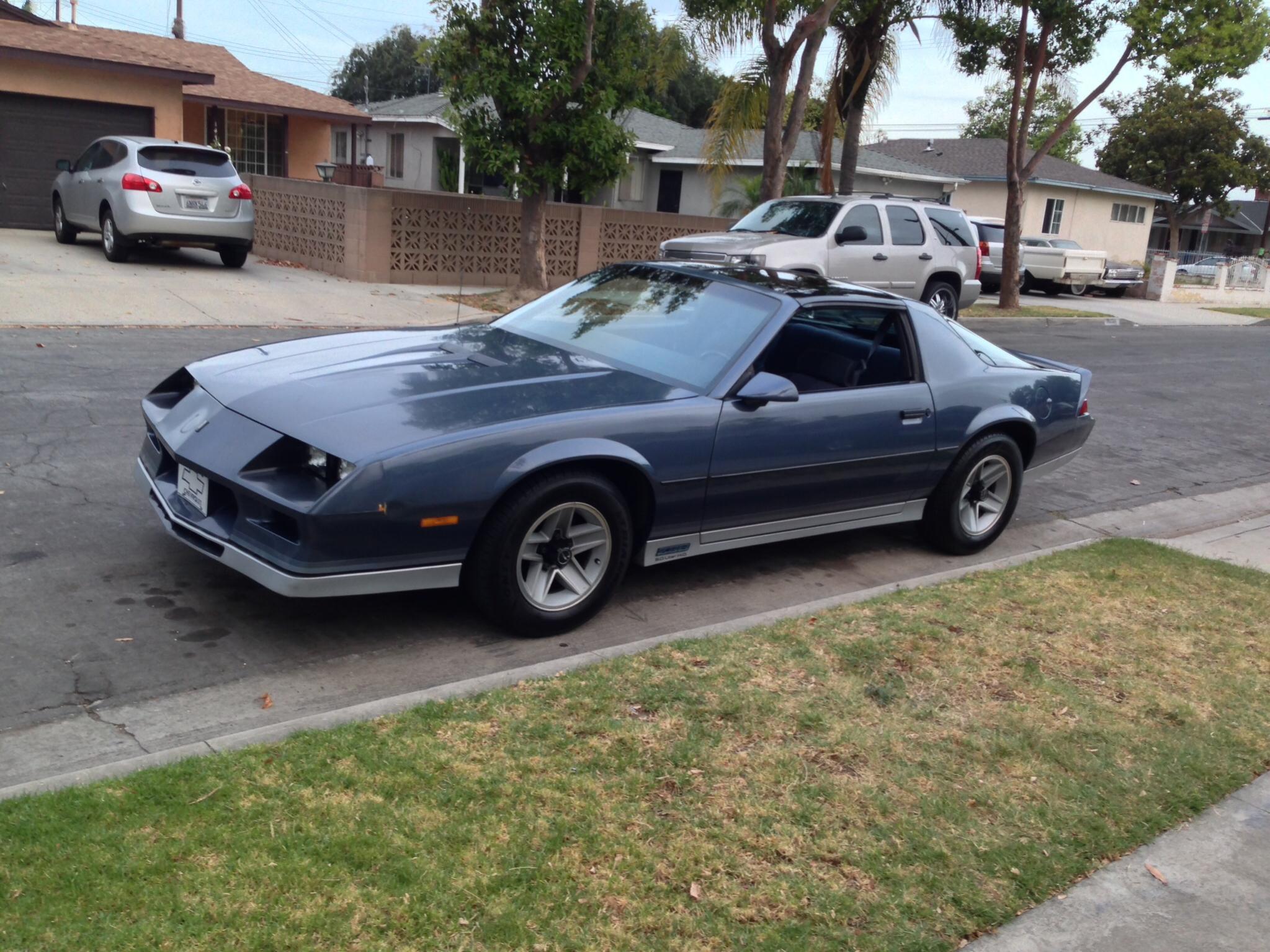

This is my car that the motor will go back into

You don't need a whole lot of wiring.
Alt
Starter
water temp sender
Oil pressure sender
Tach signal wire
HEI 12 volt switched
Elec. choke 12 volt switched wire
Heater/AC
Windshield wiper motor
windshield washer pump
Horn "
Front lights (headlights, blinkers, parking lights)
