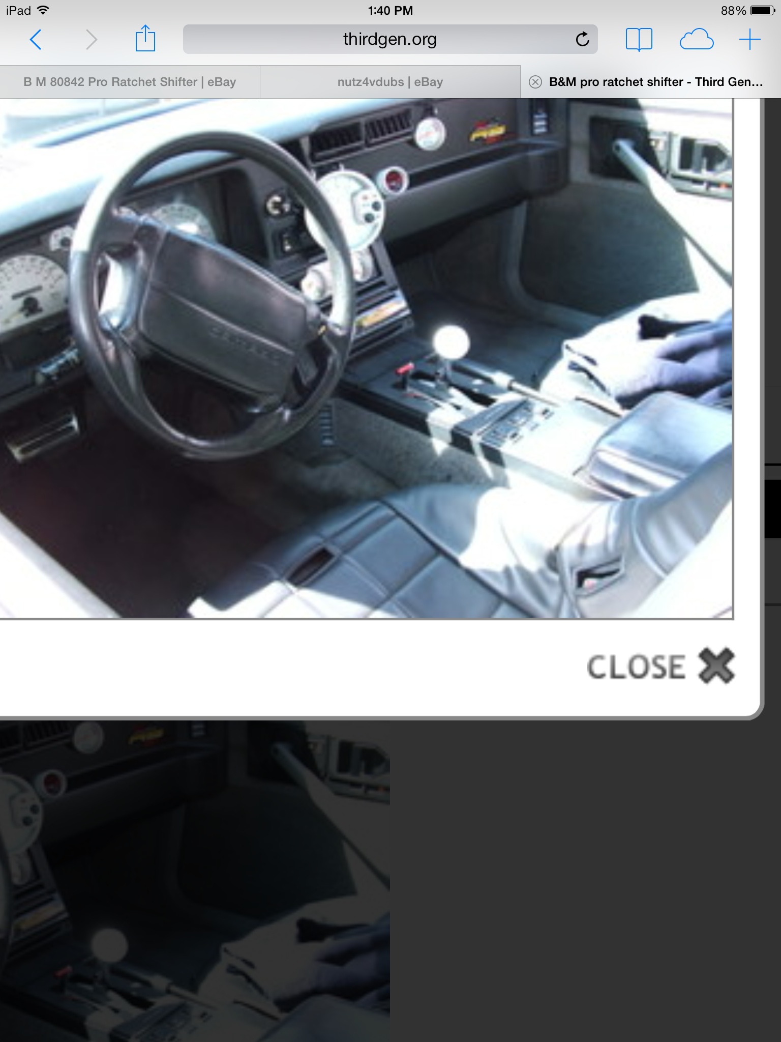

And I'm hoping its a nice street ride when done. It isn't bad now I guess, just like more. As we all do. Also just picked up a b&m pro ratchet shifter, going to make it look stock. Love the slight and subtle queues. I will be obtaining more of the auto shifter plate than this image, but you get the idea.
Similar to this image:

I had the B&M shifter for almost 20 years LOL, it looked cool stock but it really is a crappy shifter compared to what I have now.
I changed to a Turbo Action Cheetah Shifter when I replaced the 700 trans with the turbo400 and 'brake. The difference in quality is night & day. !

Could you see the image?
Stock looking is what I'm going for, lol

Oh ok. To bad, enjoy seeing others cars.
