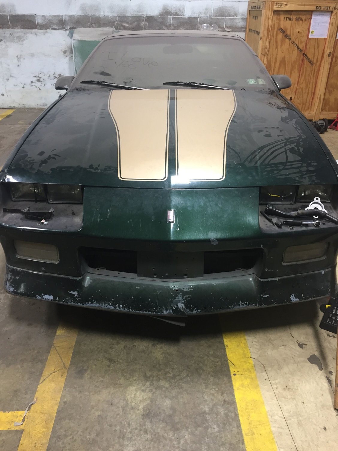

Over the last year ive been swapping out my 3.1 v6 with a vortec 5.7, vortec is in car with just about everything hooked up, swap has all vortec accessories and brackets. problems i am running into are
1. finding a way to route my hvac lines wanting to use diverter valve for my hvac vacuum.
2. how the vacuum lines route with this setup
3.deleted all emissions equipment but dont know what to do with purge canister, want to keep on car or vent it correctly. (truck had a canister and hoses routed to engine, would like to do that if possible but dont have wire connector for that cps sensor).
if anyone has or know someone who has gone this route with their swap and can point me in a direction of ideas for these few things would be greatly appreciated, so close to getting it running but clueless to this things above. Any help with any of this will help me out.
I do know this isnt the best induction route and i will be converting to tpi, but for now this is the route i'm taking!

Sounds like to me he is trying to reuse the vortec CSFI injection. I mocked up a stock L31 injection setup on my 1980 Corvette just for grins one day. The intake/throttle body/throttle body elbow are so tall the elbow hit the cowl of the L88 hood that is on the car! Even a low profile astro van tb elbow turned backwards still hit. To run that setup I would have had to cut a hole in the hood and fabricated me a 2nd gen Trans Am shaker style air cleaner of sorts.

yes that is correct Fast! I haven't tried putting my stock hood on yet but i think it will be close. carb would be a route but being that i paid 500 for the custom harness for this setup i want to try and make it work. im going to see if hood will fit today! just need to know where my heater hoses and vacuum lines needs to be run to make it operate the way it supposed too.

Hood actually does fit no problem, I had a problem with my latch. So to anybody wanting to know if a vortec truck setup will fit under stock hood answer is yes. Fits with all from truck accept air conditioning so you have to get the ac delete idler pulley.
With accessories off
