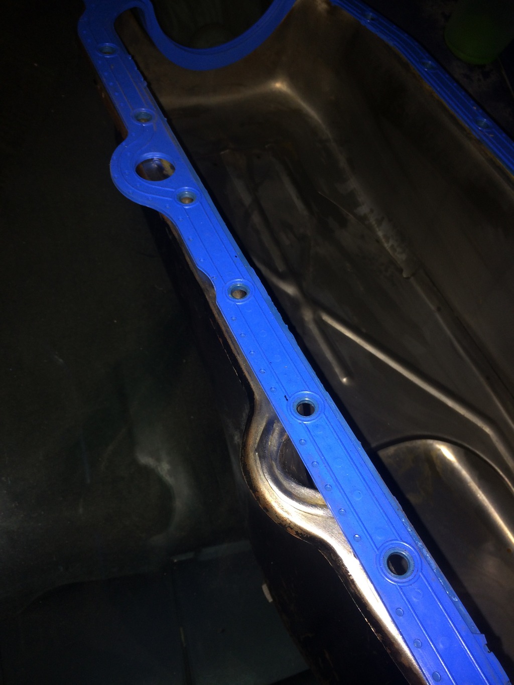

So I got this one piece felpro. But as you can see. The dip stick notch is way further back on my pan. I asked autozone for 1990 camaro RS v8 5.0
Any advice?

Re: Can't find the correct oil pan gasket
Ok so I figured it was swapped. And also some one told me that third gens do Not have the dipstick on the drivers side. They are all only on the passenger side. If so how come they still gave me the gasket with the dipstick notch on the drivers side when I asked for 90 camaro
1955-79 2 pc. rear main seal, driver side dipstick
1980-86 2 pc. rear main seal, pass side dipstick
1987-up 1 pc. rear main seal, pass side dipstick
