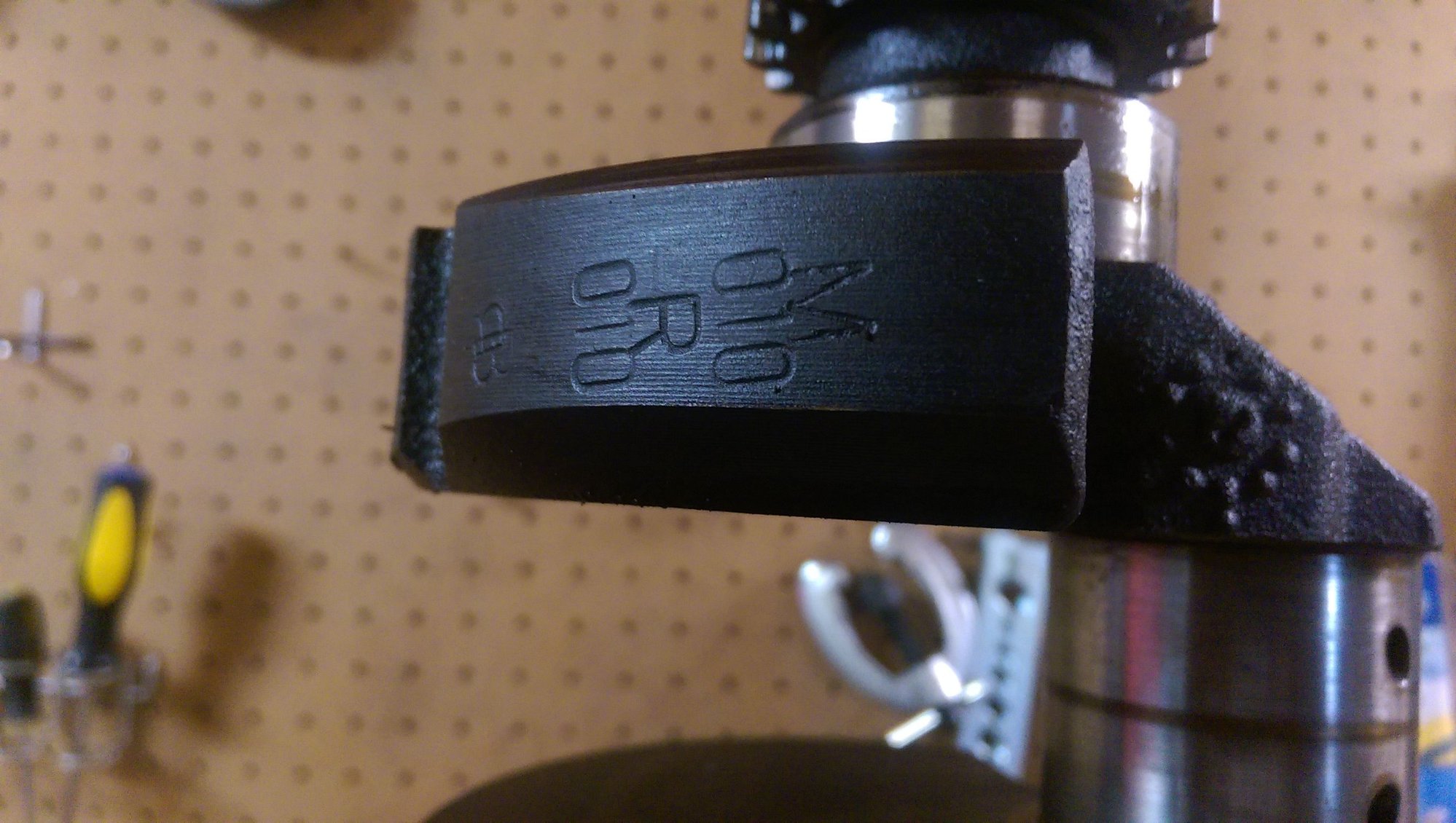

I have spent the last couple days angry that this crank is holding up my by build again. I was out in shop when I noticed this (see pic) . If it was ground .010 there is no way I was getting some of those measurements.
Then the lightbulb came on ! The micrometer I used was that dandy piece of shat from HF. Grrr... A quick trip to friends house to borrow his more accurate Mic. Journals are now 2.089 and 2.439/2.440.
So engine guru's ,,, if I run .010 bearings will that get me back in the game ?
