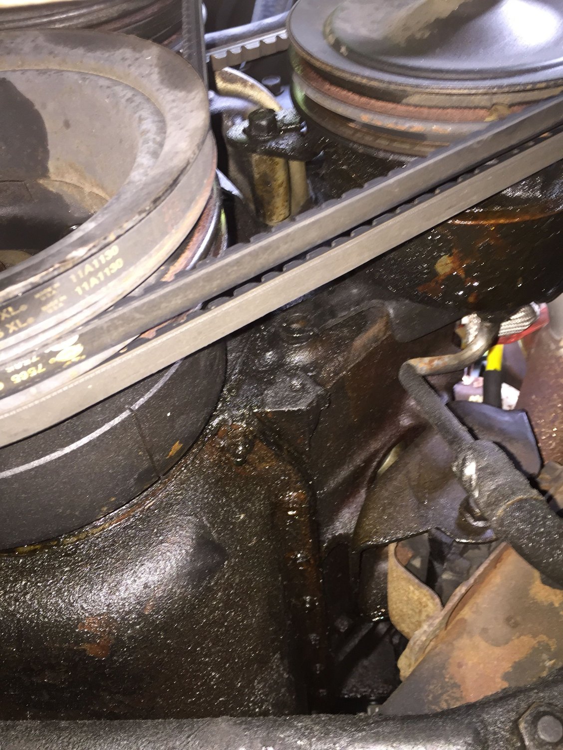

What bolt is this?
i was installing a new lower radiator hose when i realized that i am missing a bolt by my power steering unit. Does anyone know how i can figure out the size/length/thread for this bolt?

Re: What bolt is this?
3/8"-16 thread and I can not remember length but I would guess 1"
Shove a screw driver in the hole & measure the length.

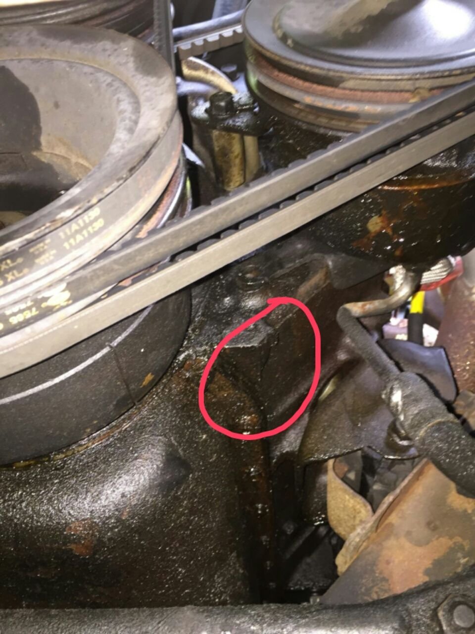

Kinda off topic. I may be wrong, but is that a crack?
That's disgusting.
Give that poor thing a bath and a power steering return hose!!!
Thats EXACTLY what it is.
I know lol it needs a bath, car has sat for a while and i am trying hard every day to update it. I didnt even notice if that was a crack or more grime but i will definetly investigate it further.
