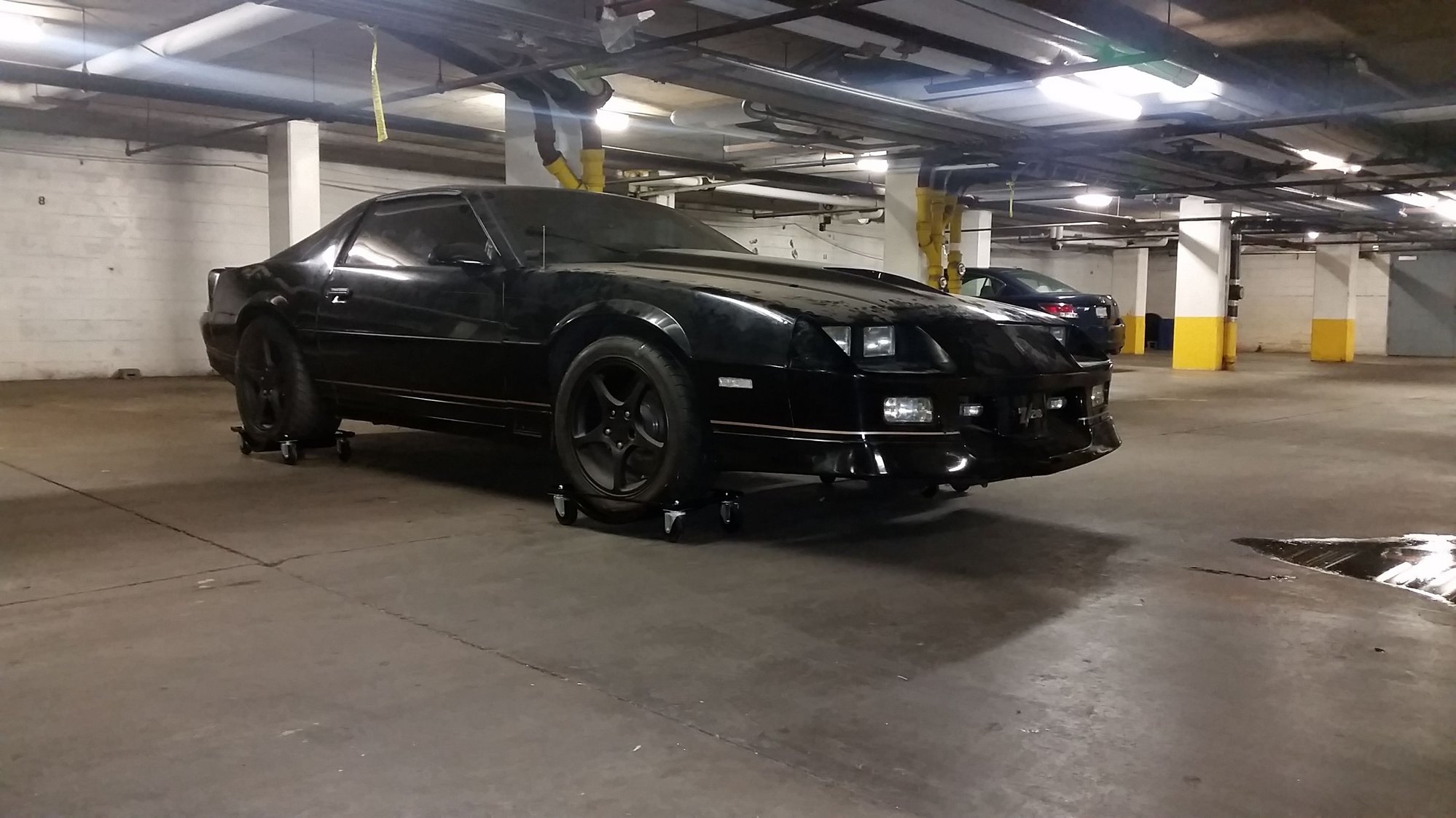

Hey everyone, I really have not been around latley life has been keep on kicking me down financailly... and cant get the rest of the money together to get my car back on the road..
the car is an 87 iroc , h/c/I/ and a ton of other stuff. ( 350/700r4/ borg warner rear.
I have not started this car in years for a couple of reasons, its parked at my dads apt 30miles away, blown trans ( is why i parked it )
It is waiting on a t56 swap , which I have mostly everything for , but gauges,some bolts, sound deadining and some fluids. unless I forgot other stuff.
I however dont want to screw my car up any more and AM TRYING to get a complete list of what I Should do before start up.
I assume I will have to drain gas ( whats the best way to do this? just unbolt it from the fuel filter?
charge or replace battery.
drain oil, coolant, rear end fluid then, pull the sprark plugs and spay a nice three count of wd40 in ?
anything else?

HOA lol pfft.....
Sorry. Good looking car you got there. One thing missing... you in driver seat going down the road. Good luck with the work. One thing at a time.

Thank you, I've said pff to hoa, but they got cameras in there and have caught me one to many times ,they said next time they catch me working on my car I'll loose the spot. And I do gotta say I like having a indoor spot away from the weather and the elements.
So I'll tow it to a friends house with a garage spot (one car garage ) so it will be tight, a pita to do work but it's in doors.
