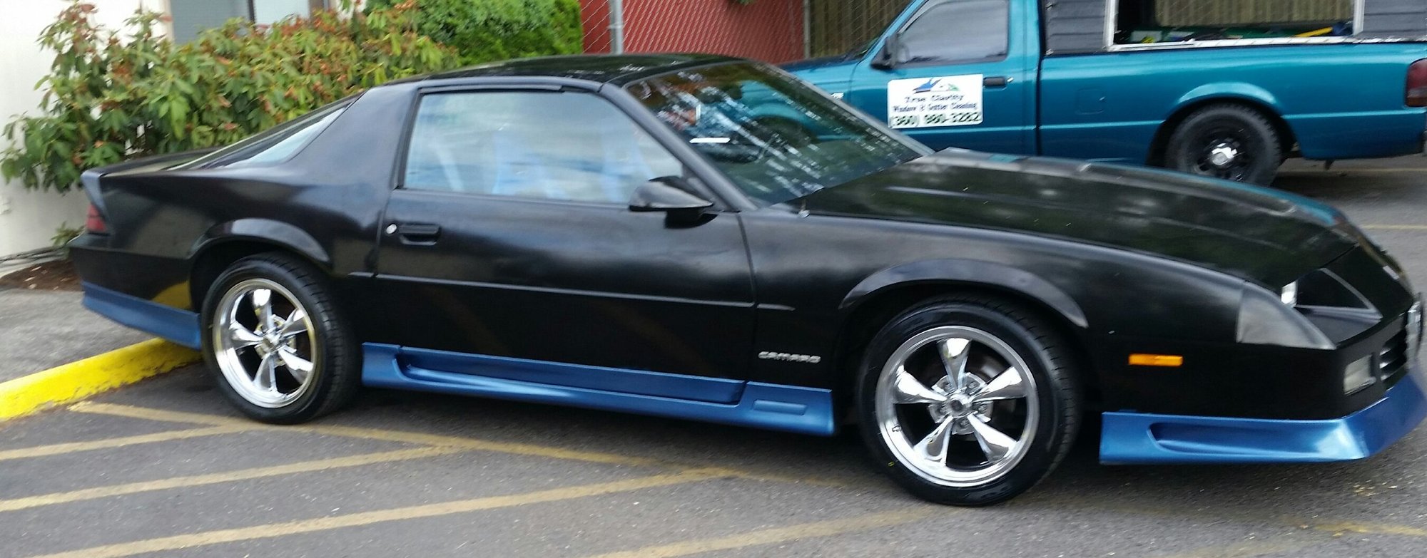

So I've got a 91 RS and I'd like to share my game plan for it and get any input or suggestions anyone may have on it.
The car is a 91RS. 305 TBI, 5speed T-5WC.
Here's my list. (Bodywork, Fiberglass ss hood, Wheels/tires are checked off the list).
Exhaust 3in single from headers/manifolds to stock duel split with flowmast 10 or delta 40.
Subframe Connectors
Upgraded Suspension (haven't decided on what, Suggestions would be appreciated).
New Posi Rear End (Thinking 98-02 4th gen. Thoughts, alternatives?
TKO 600 transmission. (Seems like the way to go. Thoughts?)
Then when thats all done I'll be dropping in a 350, 650-750 carb, Vortec or Trickflow heads, headers, etc. Want a number close to 400HP.
I won't be taking this car to the track or anything but if something pulls up next to me at a stop light or wants to throw down $100 I won't hesitate and of coarse I'll do my duty to embarrass the f*** out of any civic owner with a cherry bomb and green rims that think they're a speed racer lol. Most of all I want something solid and well done that I can appreciate for a long time.
Any Thoughts, Suggestions, Input, things I didn't think of, etc would be appreciated.
Thank you!
