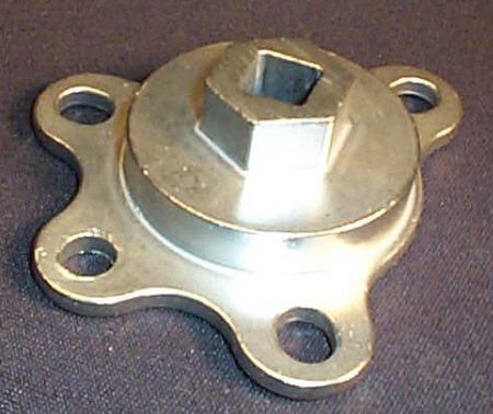

I went to an exhaust shop & bought some studs, I loctited some nuts on to the studs. I used these to replace the regular pulley bolts from then on. I have one of these crank turning tools & have the nuts wired tightened to them so I don't lose them.
