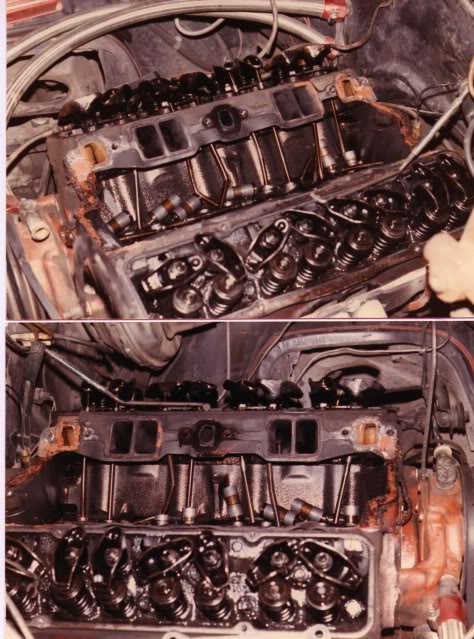

looks like the rocker arm adjusting nut backed off, notice how much closer it is to the end of the stud than the others in the pic..
this is what happened on my Nova about a decade ago when a poly lock backed off on the #1 exhaust rocker when i was driving home from work one night... heard a bad ticking noise for about a half mile, pulled over to check it out, and it quit... so i drove it the 5 miles home and pulled the valve cover to see no pushrods for either vavle on the #1 cylinder... i pulled the intake, and this is what i found:
2 new roller rockers and 2 new pushrods from GM cost me about $120, and i triple checked the poly locks when i put it back together..
