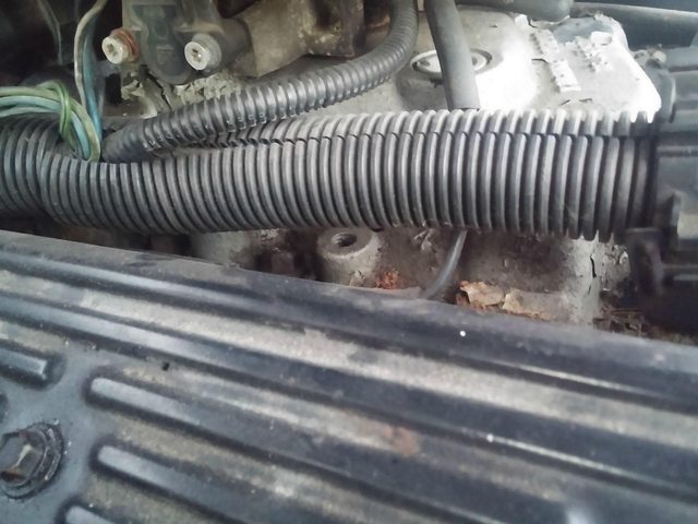

Soo... uhhh
Should something be bolted in this hole? (Right next to the coolant sensor, front of intake)

I think I found the source of my oil leak you guys...
![Skeeter Foggin' [Updated with Compression Test and Spark Plug pics!]-mdfk5hzl.jpg](https://www.thirdgen.org/forums/attachments/tech-general-engine/460738d1683130442t-skeeter-foggin-updated-compression-mdfk5hzl.jpg)
...how about this one? (IS THAT A MAIN INTAKE BOLT HOLE??!?!!?)

Lets not be SO fast to declare the intake manifold as 100% being your problem here !
In the pics you show , I see nothing that would explain oil leakage into the cylinder(s) . The empty holes you show , as well as the partially screwed in bolt , are not holes for hardware to hold the manifold to the engine , those are holes for hardware to hold things to the manifold . Things like the missing brackets for the missing AIR pump , for instance .
If those holes were anything other than castings to hold brackets & such , you would surely know it by the massive leaks of both vacuum and coolant that would be caused from a not bolted down manifold .
The threaded rod picture isn't clear enough to me , but sure looks like a factory stud that had something mounted to it (like that mising air pump) . I'd like to see a few more shots of it and the rest of the top of the manifold also . In the meantime , I would suggest still doing your compression and leakdown checks , those are a really good indicator of just exactly what your dealing with , no guesswork required .
PS , a reading of manifold vacuum is another piece of the diagnostic puzzle that really should accompany the compression & leakdown tests .....
