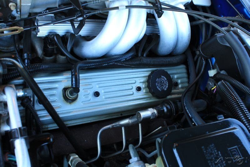

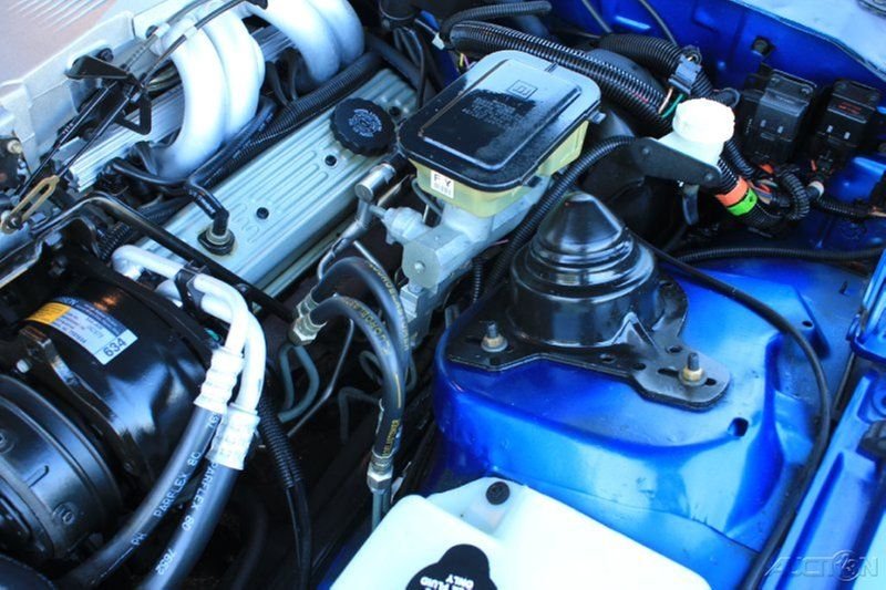

Re: L98 Air Conditioning Bracket Issue
The brace looks to go to exhaust bolt #3... in front of port #3.
The final pics gratuitous bracket setup shots. I think the tall valve cover bolt is in the way of the braces, and the header does not have an extended boss to support the bracket.
From another TGO thread...
https://www.thirdgen.org/forums/atta...0110206_4a.jpg
