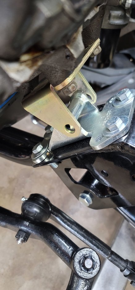

Umi k member with moroso solid engine mounts
Anyone have this setup? I cannot for the life of me get everything situated in there correctly. It's all new. Neither the k member nor the engine mounts have been used in this car. So it's hard to say which one is at fault. Worst case scenario I'll put the stock mounts back on and see if those work

Pry bar and move the engine around
Mine was like that

Once I bought the solid UMI mounts I was able to get everything settled. Mixing and matching aftermarket LS swap parts is always an adventure.
