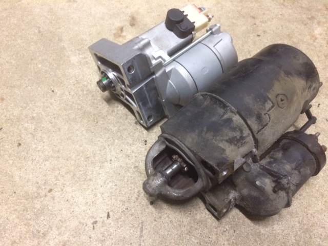

Well, based off info I read on a few threads here, I decided to install a starter from a 93-96 Corvette into my 1991 Z28.
it didnt go so well. The wiring doesnt reach the lugs on the starter and it looks like I would need to notch the plastic flywheel shield a bit. Either way, it dont work.
Anyone else have this issue? 1991 350 tpi car.

Re: corvette starter does not fit. (wiring too short) 1991 Z
Normally have to reroute the wiring and remove it from some factory routing clips. Just a little fudging and they'll be long enough to work.
Shouldn't have to notch the shield at all but even if you do, it's worth it.
I have the starter on 3 of my cars with no issues.

No, don't return it. The new part has things in a little different spot so you'll have to do some minor mods to make it work.
I really doubt anyone will say, "hey, did you see that guys tq converter cover has been slightly modified and he re routed his starter wires?" as you drive by.. ;-)

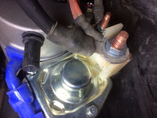

BOOM!!!
Its in! And it wasnt fun! Harness is still a little tight but thats all I could get out of it. This is a bone stock engine so all the factory crap is still attached which makes it hard to get your hands in there to move things around.
Couple things that needed to happen to get this in.
---remove the wiring harness clamp that was attached to the block above the RH engine mount.
---slide the black power wire about 2" further to the back.
---remove/cut the little tab on the ring terminal on above wire.
---grind/dremal some of the plastic away on the divider wall so the ring terminals could fit.
---grind/dremal a small amount of plastic on the flexplate shield.
Im not 100% sold on this starter right now. Car is on jackstands getting a brake overhaul so I was only able to start it a couple times in the garage before fumes set off the CO detectors in the next room. I feel like I have to hold the key in the start position too long and when I release it, the car wont turn over. I have to crank it a second time for it to fire up. It did that 4 out of 5 starts.

Originally Posted by BOTTLEDZ28
I just went back to the garage to see what I could do with the wiring. Its not happening....at all. I managed to get the get the wires a little closer but I need a bit more in order to get the terminals to seat right on the lugs and there just isnt anymore left in the wiring, especially the harness that runs up behind the AIR pump and then between the valve cover and intake. There is no way that bundle of wires is getting tweaked to get me another inch.
I need to go to Plan B or maybe C now. This corvette starter isnt going in
just put it back like it was . why make problems for oneself ??

Just to chime in here:
I ran into the same issues when I put my 'Vette starter in my 92 Z28. I could have snapped a pic exactly like yours, it was that close. I ended up removing clips as suggested above and basically re-route the wiring until it fit. Tight fit but worked. Also helped when I got my new Optima battery as the terminals were a bit closer to the wires than the older style Optima it replaced.
