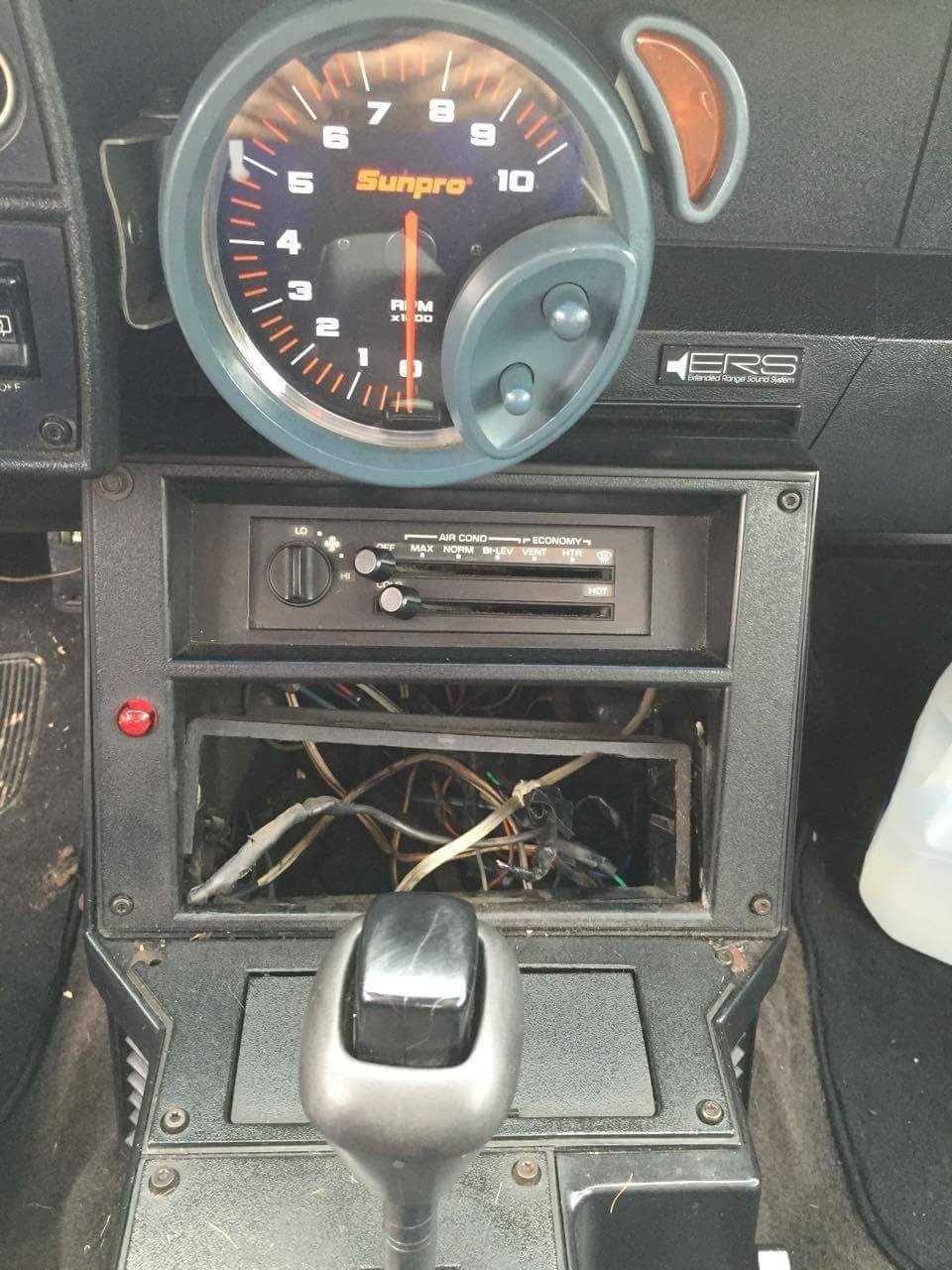

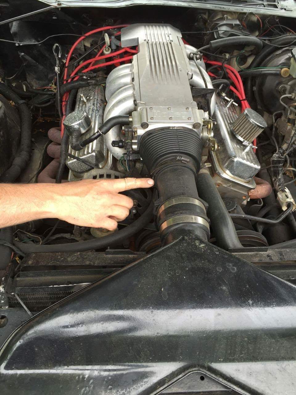

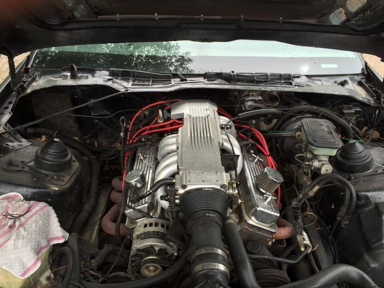

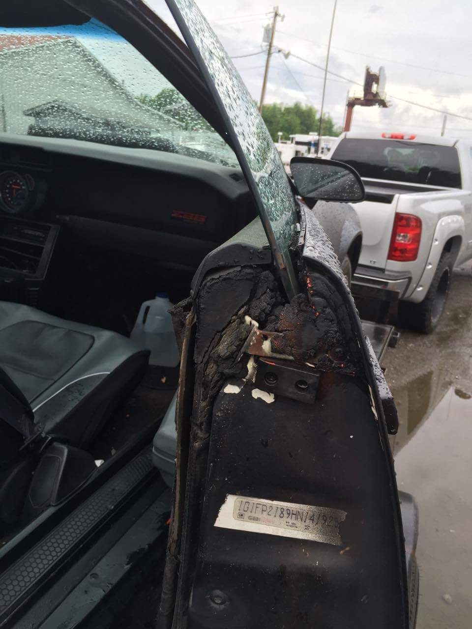

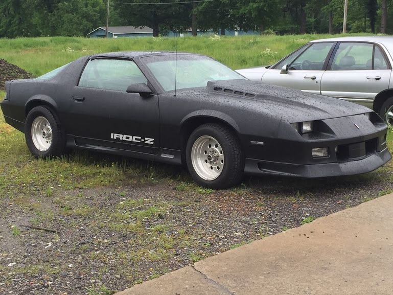

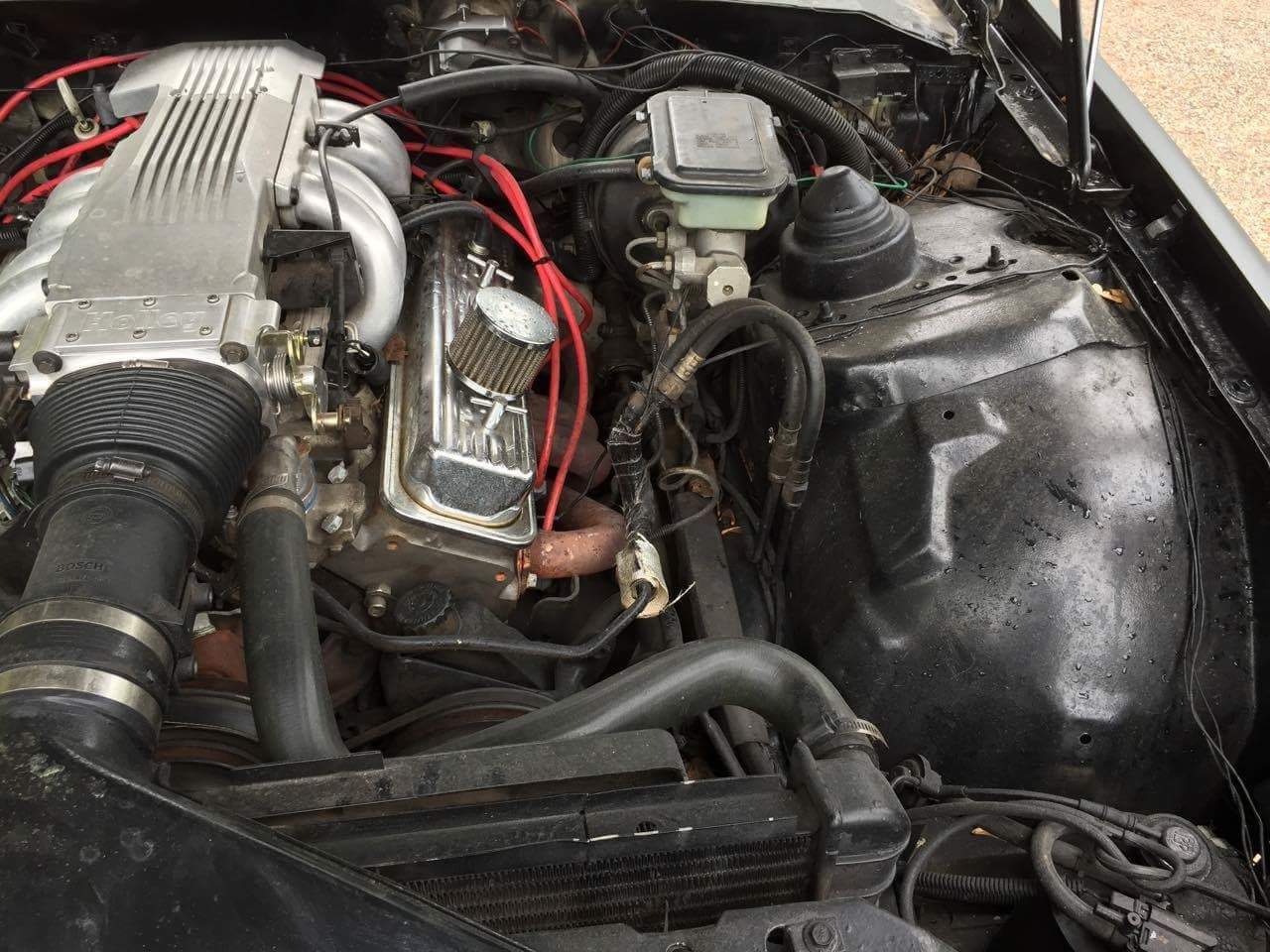

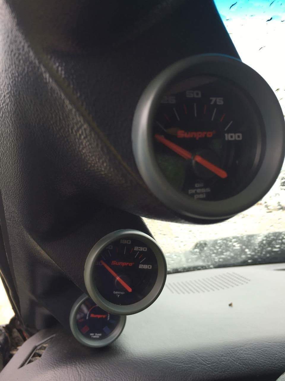

Got these today

Old Apr 30, 2016 | 05:22 PM

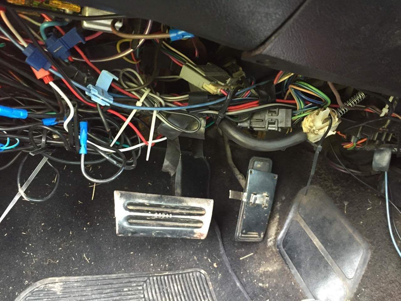

Posts: 28,031
Likes: 2,500
Re: 1987 IROC-Z 5.7 Low Oil Pressure, Overheating...

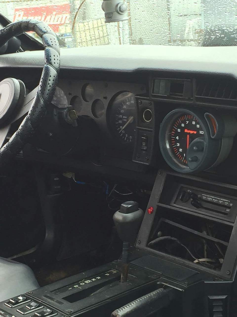

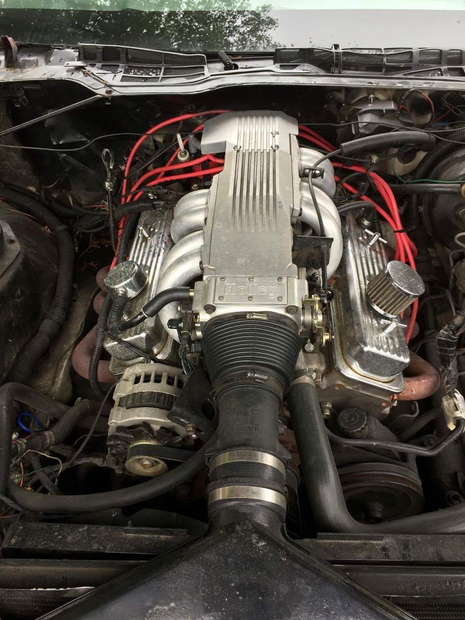

Arnett Racing doesn't "make" transmissions. They REBUILD em.
It's some kind of transmission or other... most likely the stock model (700-R4) or maybe a Turbo 350. Google "transmission pan identification" and compare the one in the car to those. I'd be expecting stock though, especially with that stock shifter in it.
The engine LOOKS, for all practical purposes, bone-stock (except for the Holley TB). Not sure why someone is pointing out the Bosch replacement MAF... that's something you'd pick up at a parts store, of no particular consequence. Gonna be pretty hard to get it to idle right, with the hack job on the PCV hoses and those "breathers" and all that. But easy enough to fix, and cheeeeep.
I don't see any evidence of nitrous on the motor, but that's not saying a whole lot; it'd be pretty easy to take the kit back off, especially if it was just a dry hit, and not leave much evidence. The car looks like it's had it; but not the motor.
That gauge pod is just ... hideous. I have never understood those things. Same for that utt bucking fugly hood. I guess some people like them, but to me, they just look... trailer park.
I'm not seeing ANYWHERE NEAR any $8000 worth of work there. More importantly, I'm not even seeing that you'll have a $8000 car, after paying somebody else $8000 to work on it. You could throw that car in the trash and buy a REAL NICE one for $8000 and spare yourself A BUNCH of trouble and risk. It doesn't make the slightest bit of sense to spend that kind of money on that particular car.
Now for YOU to work on it, in a common-sensical kind of way, starting with the most urgent needs first and leaving things like "rebuild motor" until you get around to where EVERYTHING ELSE more urgent is renewed, that's a WHOLE OTHER MATTER than "shop".
Why did you buy this particular car in the first place? What about it appealed to you? What are you hoping that it will be when all is said and done?
Update. I have driven the car today. Ending up swapping with a 305, used same heads. Car drives great. Starting to tear down the 350 to swap back out when I got time. Having problems with the idle. It needs continual throttle to run, it does better when its in gear. No overheating issues thank God. So I'm now trying to fix this idling issue. I was thinking IAC because I had a similar problem on another car. Here's the run down. It's reading a real rich air fuel mixture. I can smell fuel every now and again. It'll die if I don't hold the throttle down. So I have been going sideways all damn day shifting from neutral and gunning it in over drive. I got back to my house and was having trouble getting it to turn over at all. Again, same fuel smell, and it seems like it is bogging down. I took the ground off, going leave it overnight and see if it can reset itself. A foolish gesture. I'm sure but at this point I'm on leave and just want to get want to get this obstacle done and over with. Side note, it is a fast running car, and it handles quite well. What would be a good course of action to take to start off the diagnostic process. I have pretty well all the tools I need here.
