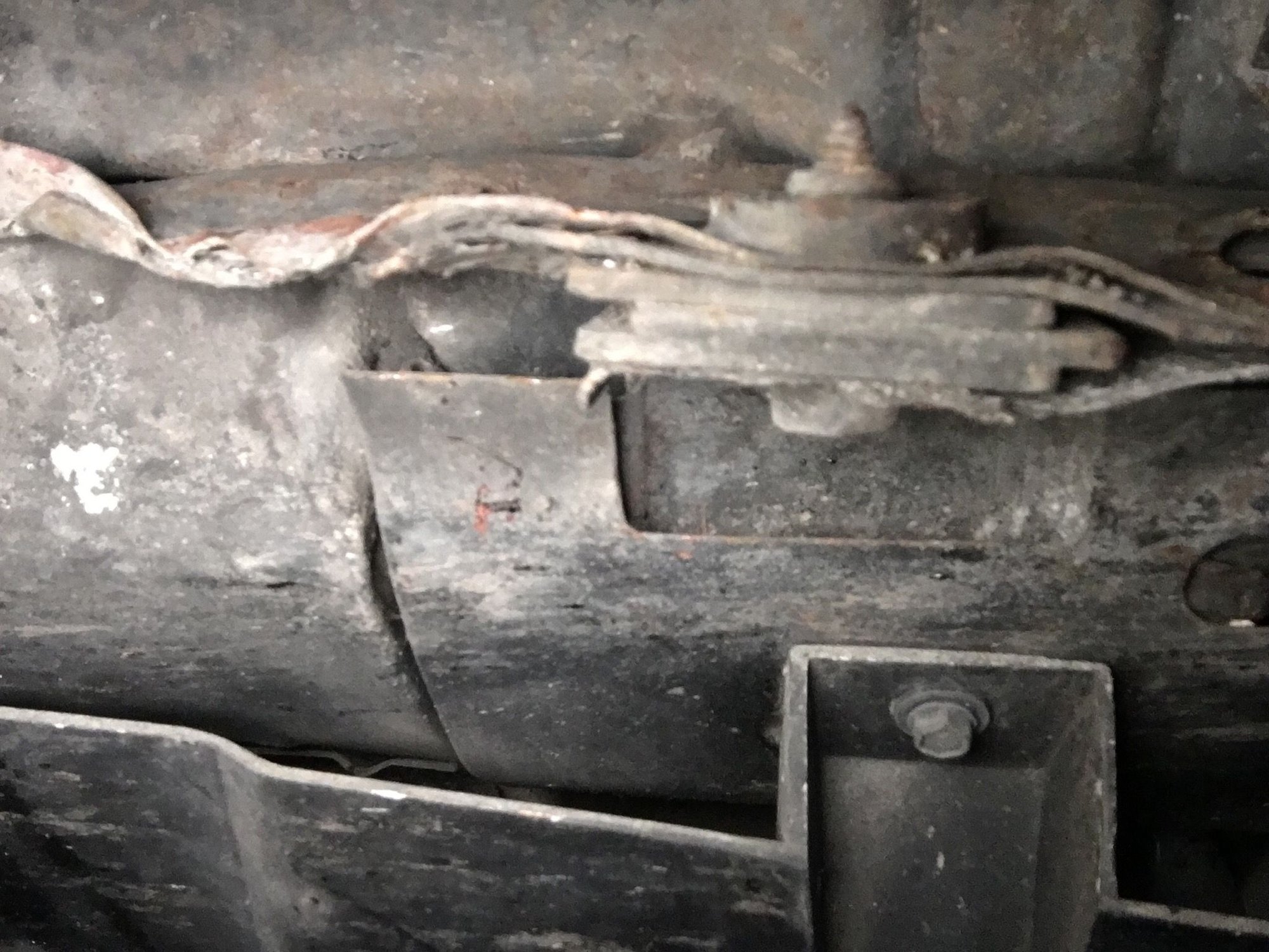

This was a great opportunity to look around the engine bay and underneath the engine/transmission area. I figured while the car was up on ramps I would look into the torque arm mount, as I recall hearing a "THUNK" on an aggressive 1-2 shift, and it looks like the bushing is shot. So that will be next on the list... At any rate it was a great day for learning on my IROC

The bushing, where you have the screwdriver, is fine. That's what it looks like when new, where it's split in half and comes apart. To the left side of that crack, the rubber is fastened to the little outer piece; to the right, it's fastened to the bigger inner piece.
Your problem is the trans mount. You can see in the pic that it's not even connected to itself anymore. Broke in half, as always. It's the rusty piece with flecks of black paint peeling off of it that looks kinda rectangular right below that bushing and a bit in front of it. You can see the gap where it's not even sitting straight on top of itself anymore, it's partly rotated and leaving a crack that's wider on the left but narrower on the right, at the bottom.
Change out the trans mount.

Loud thunk is a tranny mount. Trans hitting the floor pan axtually.

I would have thought that torque arm bushing was a goner.

Hey Sofa, you have quite an eye for detail!!! Thanks for posting this for me, I had no idea. This is why I love this site, so many great people with TONS & TONS of knowledge. I don't know what I would do with out you guys. So will my Haynes book tell me how to change it or should I search for a How To here on the forum?

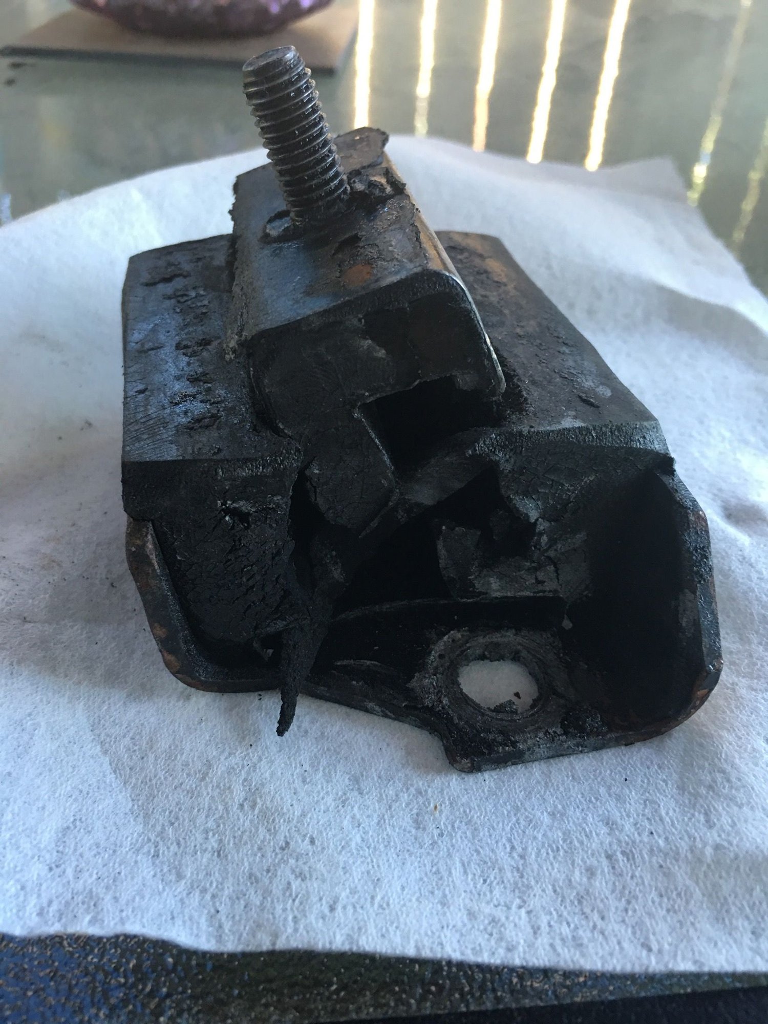

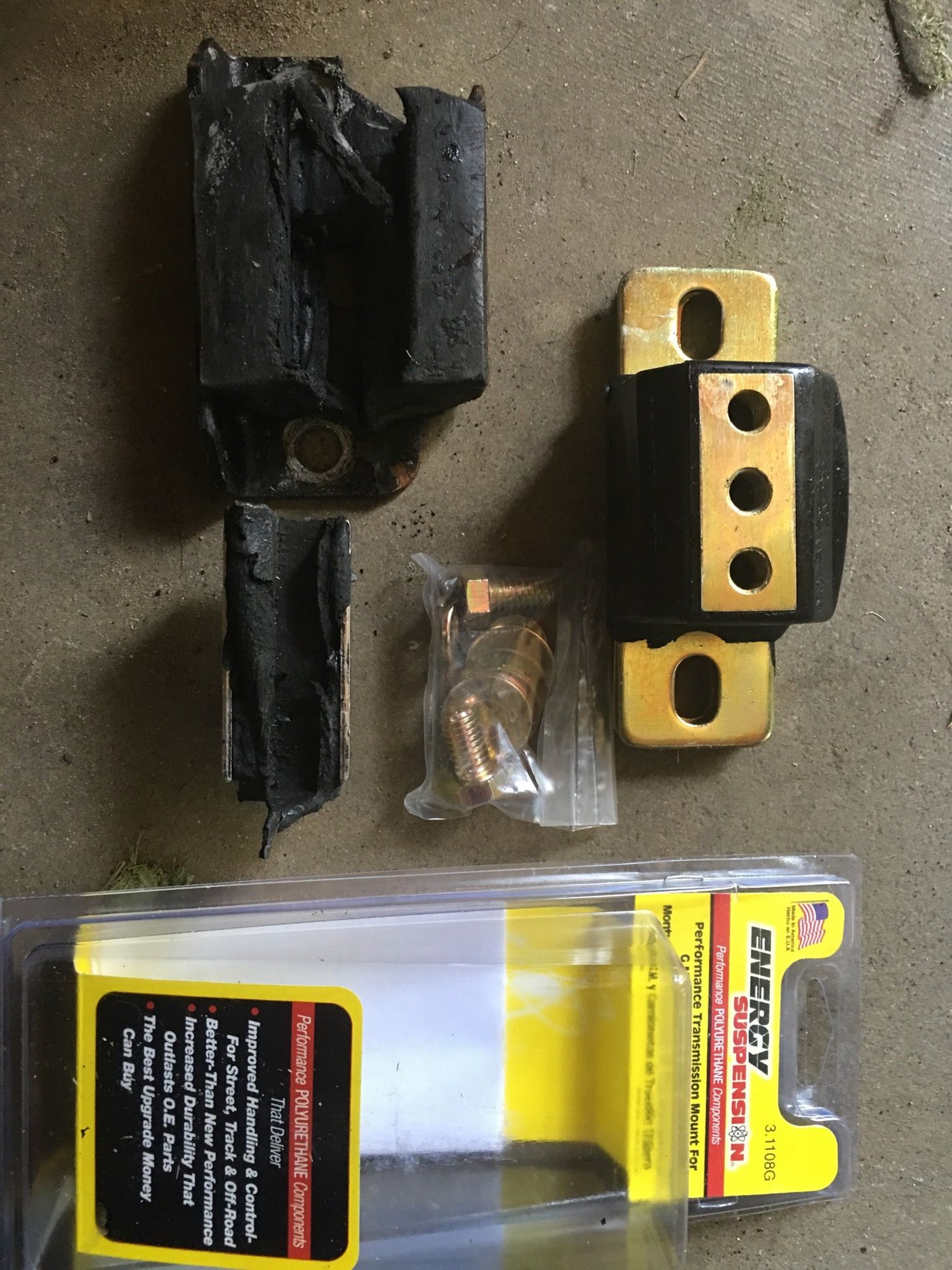

Well it was a great afternoon to be in the garage, so I grabbed up a new Energy Suspension polyurethane tranny mount and was surprised how easy it was!!! The only stumper was getting the crossmember reinstalled. There was no was it was going to fit because the new mount hung so much lower than the the OEM, I figured the parts guy grabbed the wrong package. This is when I remembered why I bought a new floor jack, my old Jack was natorious for "drifting" down, and the tranny managed to drop almost two inches!!!! So a few pumps later the tranny & mount was now above the crossmember and I was able to put all (4) bolts in without problem. So my only thought/concern was when putting the (4) crossmember bolts and the (2) tranny bolts, I used antisieze not thread lock, only because the bolts and passages seemed to have antisieze on them already. I did however use RED thread locker on the (1) bolt that went through the crossmember and into the new poly mount. Did I do this correctly or should I back out the crossmember bolts and add antisieze?

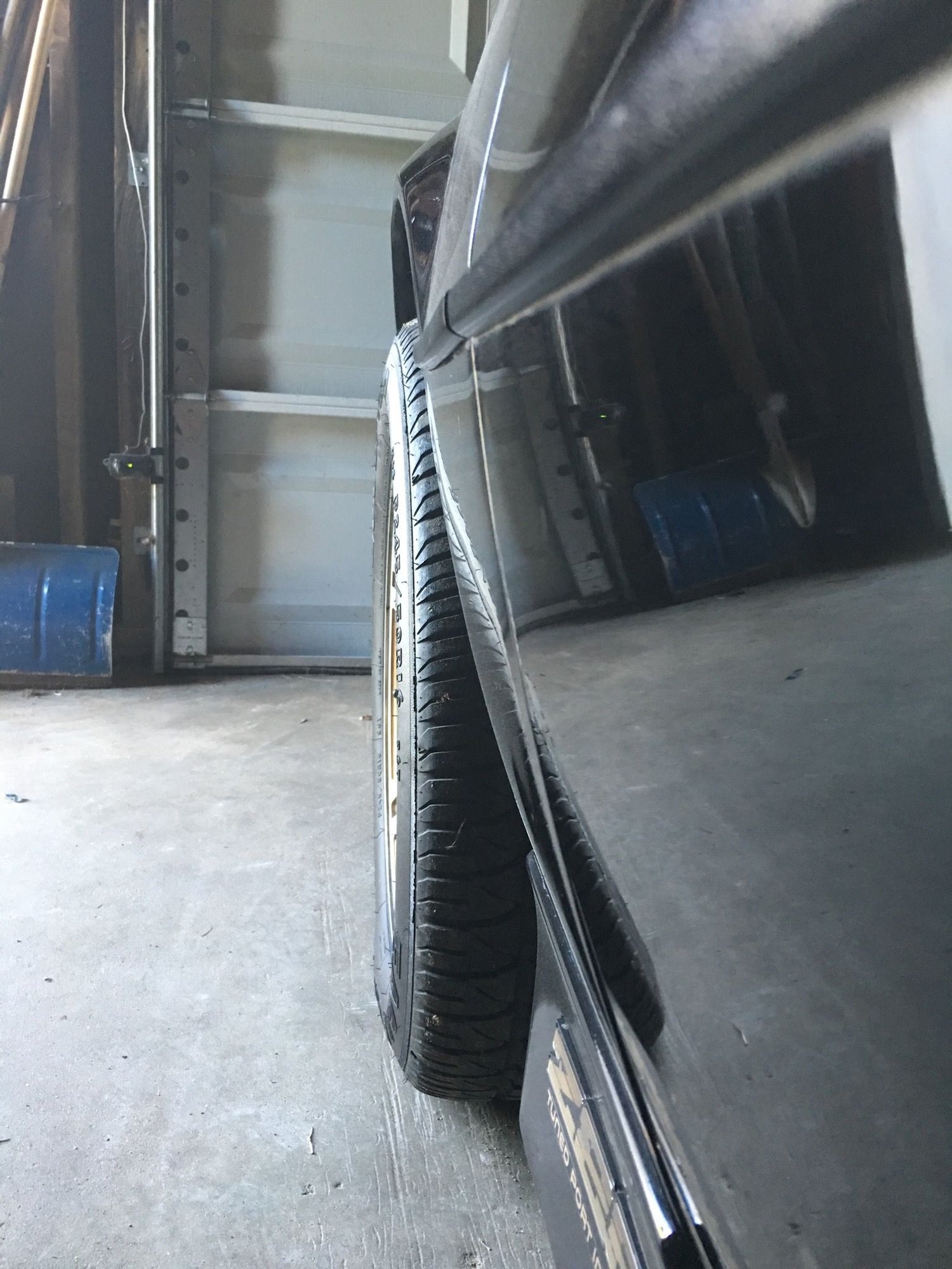

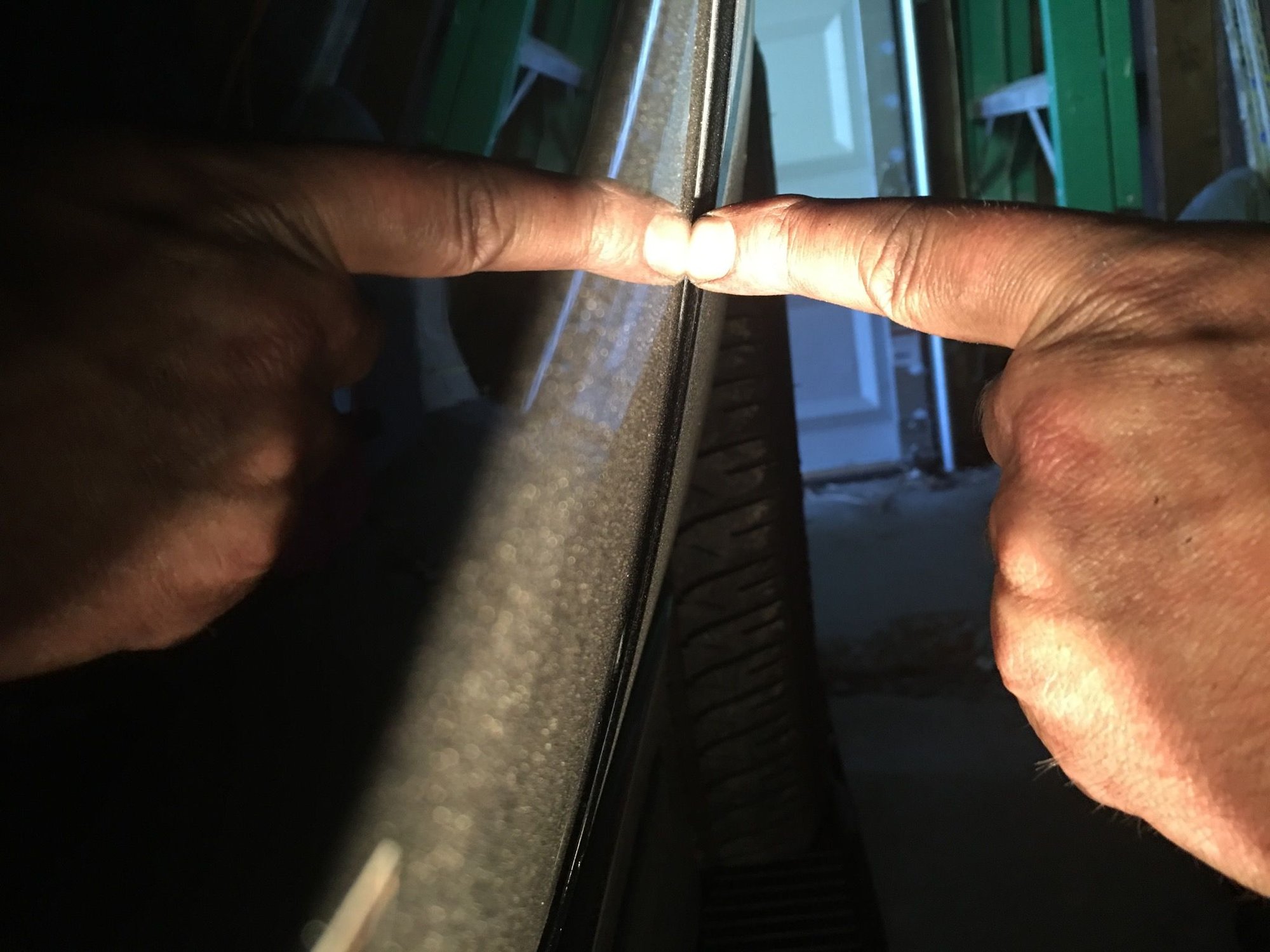

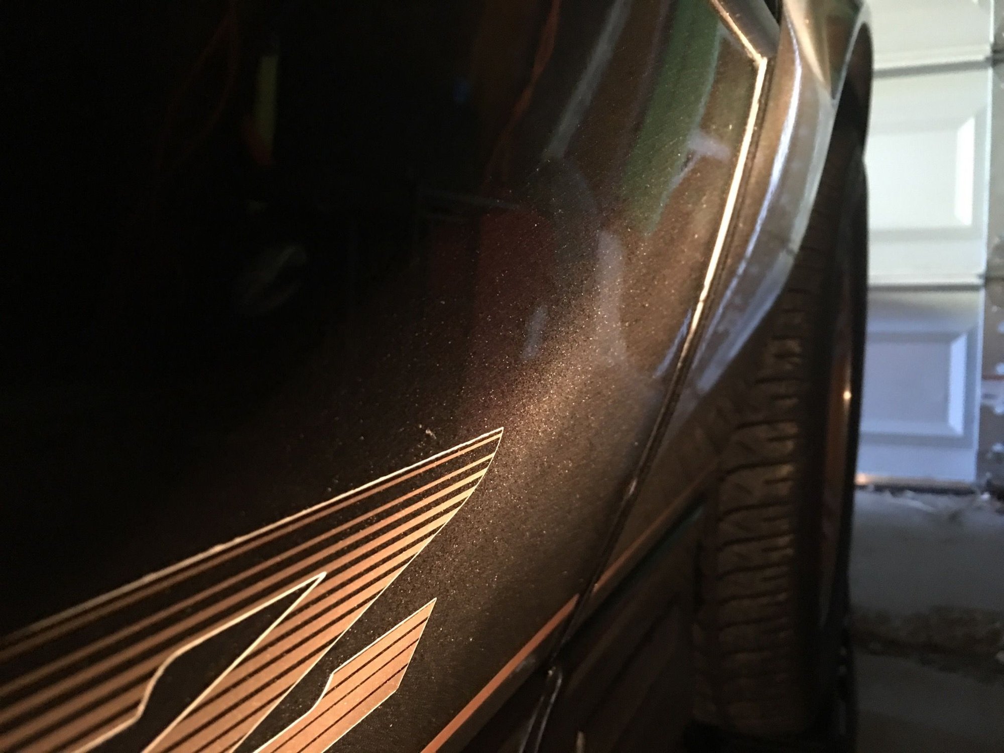

Then I could not stand my front fenders sticking out past the door prominently, you know because some JACKWAD thought it was a good idea to Jack the car up in the mounting flange of the pinch weld. So a couple visegrips and a few minutes later...pretty close to where they need to be��

Hey Tyler I can only image what a wild ride that must have been! I know after I heard my tranny hit the trans tunnel I stopped driving aggressive , not sure what the noise was, but knew it wasn't a stock option...lol

Stock mount was toast! Someone jacked up the drivers side of my car like that too. I just want to straighten out the rocker tab.
