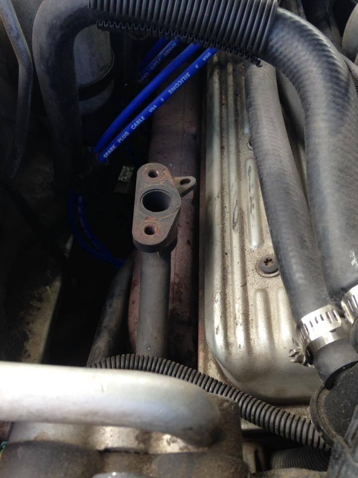

So here is my question : what is this part for ?
I bought the car and it was like this... I just wonder what is it ? Do I need to block it ?

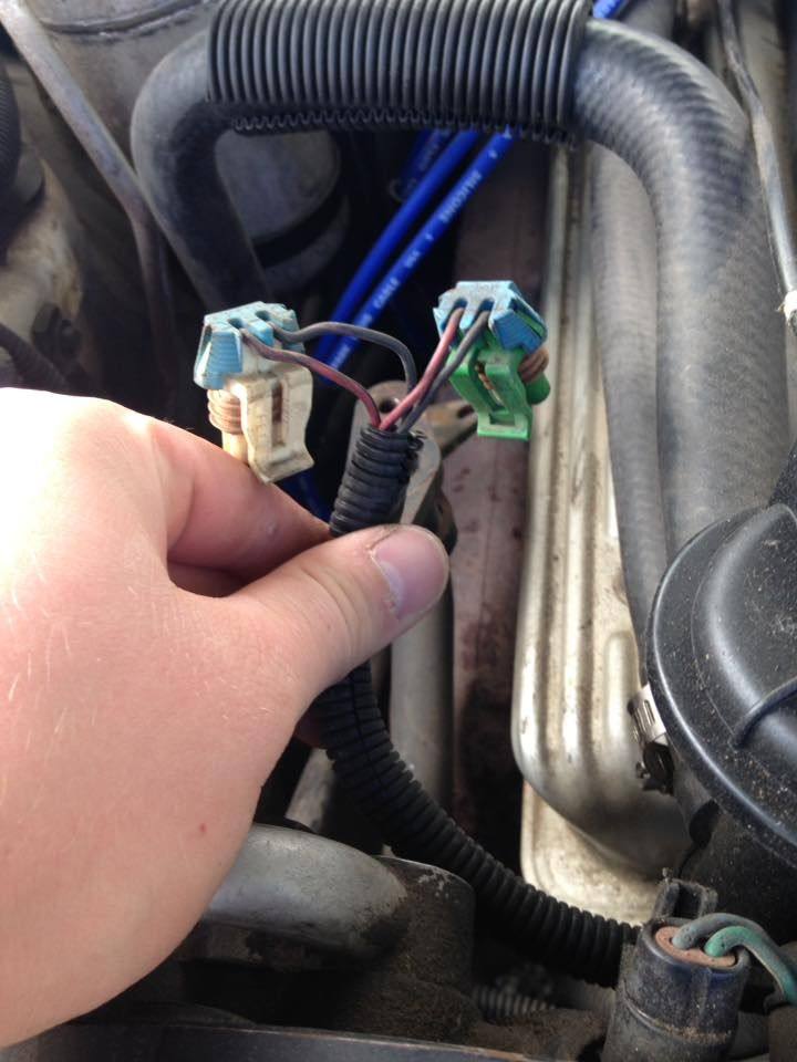

I also have those connectors... Is it in relation with the picture shown above ?

That's the air tube from the A.I.R pump. You should have a A.I.R. system diverter valve setup mounted on it and those electric connectors will hook into it to control air placement to cat or manifolds.
