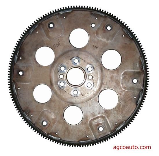

That noise really sounds like the Flywheel.

Where the flexplate typically cracks is around the crankshaft mounting bolts, the cracks will go from bolt hole to bolt hole until the flexplate is cracked all the way around and it will sound exactly like that at idle and go away at higher rpms.

i'd have to guess flexplate or torque converter bolts.
put some light color paint on the torque converter bolts, then start it up for a few minutes. turn it off and see if the paint got rubbed off. they might be rubbing the back of the block?
when i've had cracked flexplates, usually i start getting bad starter sounds.
