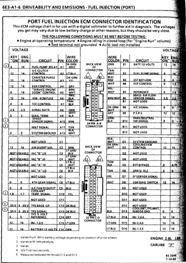

I'd check all the power and grounds for the ecm
Next to the ecm should be a connecter that you may want to check too c207
From 87 maybe the same as 88 not sure.
http://www.austinthirdgen.org/mkport..._1987_C207.gif

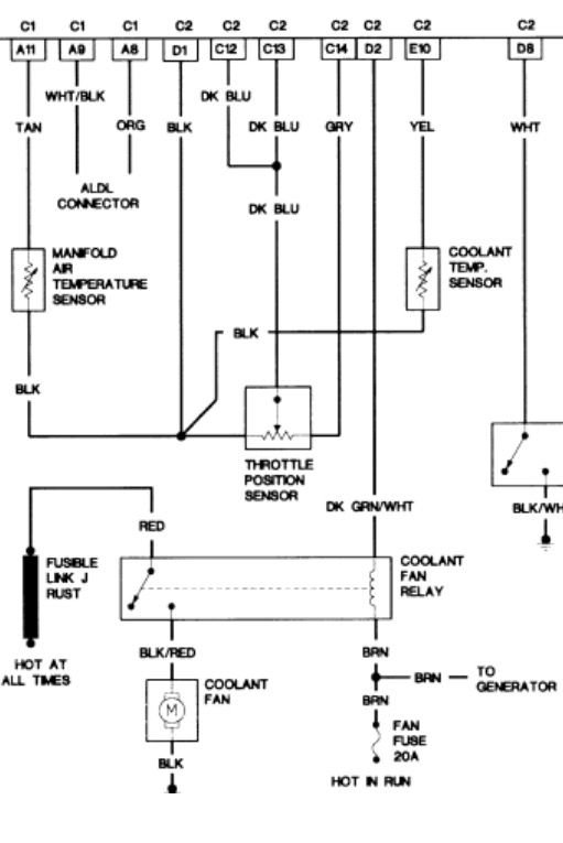

I feel like an idiot for not checking this stuff earlier, but after going through some wiring diagrams I've had to fix some of the PO's "custom wiring". It turns out while the fuse next to the battery was good, it wasn't even getting power. My positive battery cable was missing the wire that routes it to the junction box that sends power to the fan, fuse, etc. Now I've got 12v to both my ECM and fuel pump relay! Only issue is, still no SES on key ON or fuel pump action. I'm gonna try checking this ECM for codes and if that doesn't work, swap back in my original ECM.
It looks like what happened was the fusible link to the fan failed, and the PO wired it so if you connect one wire to negative and one to the positive, the fan will fire up. Does this need to be connected to the battery too? Something interesting is the fuse is getting power if you run the multimeter from the red wire to the battery's negative, but if you run the red wire to the orange wire, there's no current, regardless of whether key is on/off. Same applies to the fuse next to it.
Thanks guys!

Great news, look back at Post 10 for testing your fuel pump relay and ECM signal.
The fan hot wire goes to the fan relay . sounds like part of that circuit is faulty as well.
I think the hot at all times fusible link is hooked to the starter for the fan relay.
If you're referring to the orange wire on the other side of the oil pressure switch, this will not have power until the engine is cranking and oil pressure reaches at least four psi. If you jump or the switch connections the fuel pump would run all the time.

I'm literally shaken, turned out I had two orange wires swapped around at the relay terminal i replaced, swapped them and SHE RAN LIKE A TOP! About time!
Only issue now is she's having a really high idle, but hey she's come a long way! I knew she could do it!
